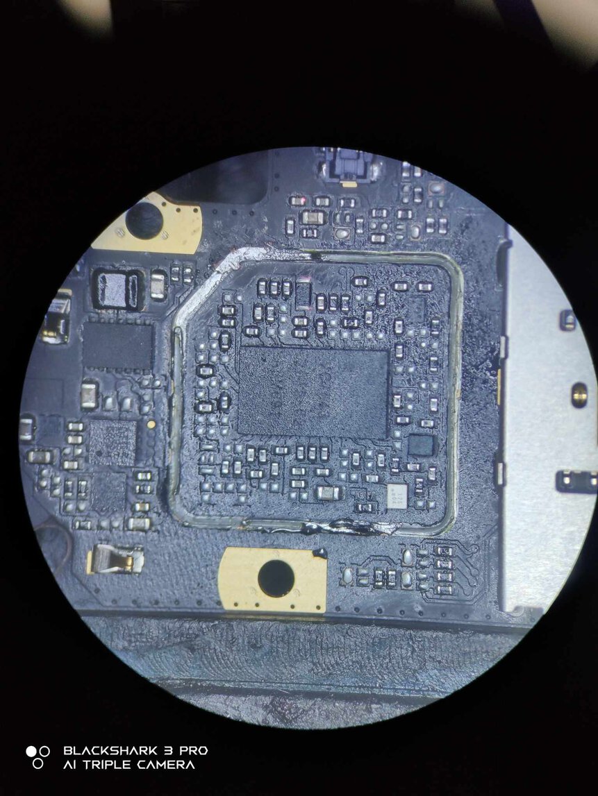

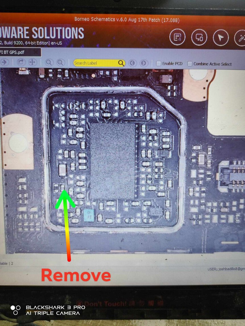

*after nya mag on sa logo then shutdown agad. akala ko i flash kona buti dikopa sinubukan pero na format ko sa UT hahahahaha.
-remove 1 caps then try kapag nag on goods na sarado na wala backjob done.

3G P.A. YAN
PAG NA IINITAN YANG I.C. NA YAN NABUBUHAY ANG UNIT KAHIT WALANG I REMOVED DYAN
PERO NAPAKA SENSITIVE NYAN BALIK BALIK ISSUE DIN YAN PAG 3X REHEAT DEADS NA YAN
ANG LIKOD NYAN AY CPU AT EMMC
BETTER PALIT BAGONG I.C. DYAN
CONNECTED KASI YAN S C.P.U.
MILD REHEAT LANG SA GILID LANG.
PERO ANG TUNAY NA SALARIN DYAN AY ANG POWER I.C.
MAG KATULAD KASI NG POWER I.C. NG SAMSUNG NOTE 8 PLUS AT TECHNO SPARK 6 KE 7
PAREHONG MADALING MAPUNDI
ITO EXPERIENCE KO LANG PO SA REDMI NOTE 9 MERLIN AT SA MGA UNIT NA YAN

tama ka boss palitan talaga para di na bumalik :D

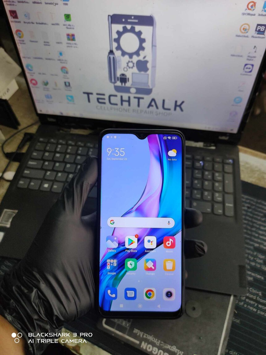

sinubukan ko yes success.. remove lang yong resistor.. sana hindi magbackjob.. tnx

Tama ka boss, tested by me tanggal metal cover okay na ang unit.
