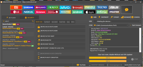

step 1 : turn off the phone longpress volume up and power button pag lumabas recovery mode bitawan mo power button tapos click wipe date yes tapos reboot
pag na reset na turn off the phone open unlocktool select xiaomi tapos hanapin mo ang redmi 9 na model click [BROM] erase frp tapos press mo ang cellphone volume up and down salpak cable hang gang mag read wait mo nalang ok na ...
done palike mga sir
