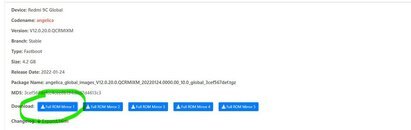

DOWNLOAD MUNA TAYO SCATTER FILE NA GAGAMITIN NATEN
https://xmfirmwareupdater.com/miui/angelicain/stable/V12.0.20.0.QCRMIXM/
ITO ANG AKING DOWNLOAD FILE NA GINAMIT .
