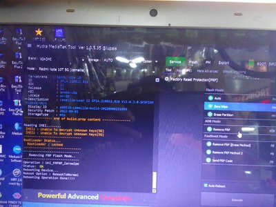

lupais Premium 2024 Joined Feb 19, 2015 Messages 227 Reaction score 194 Points 1 Location Center mall Baguio city Dec 4, 2022 #1 open hydra mtk tool under xiaomi - select exact model service - factory reset protection frp flash mode - select zero wipe hold both volume for boot nakalimutan ko na picture finish produck pero tested yan
