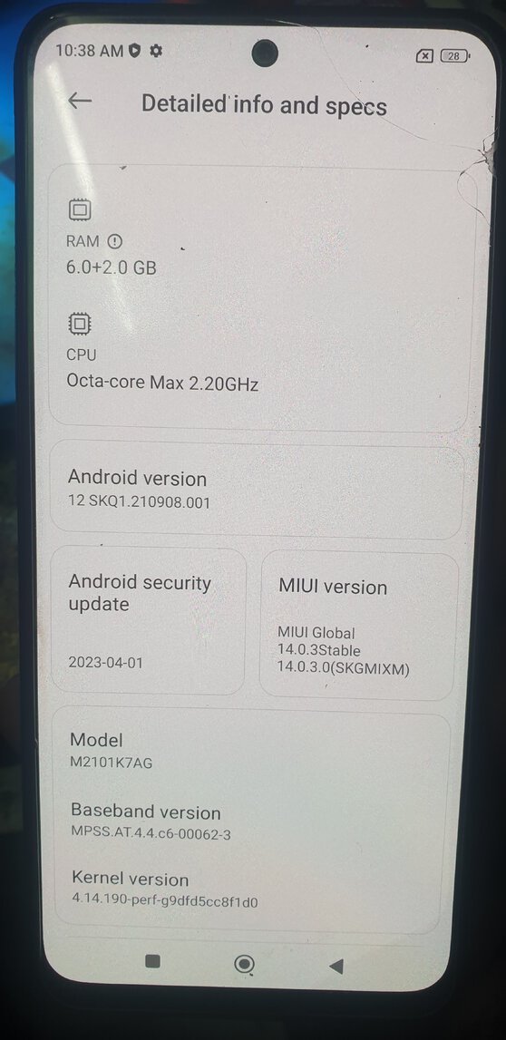

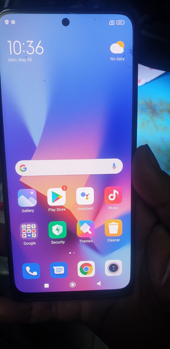

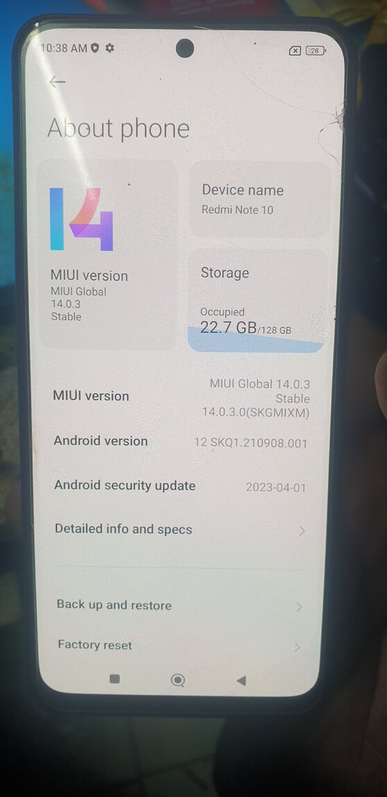

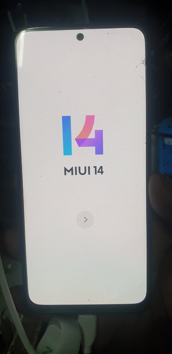

share ko lang dala ni tumer redmi note 10
reboot lang daw nag hang logo na
first try ko muna restart uleh gamit volume down and power botton pero no lock
kahit reset ko na sa UnlockTool via tp. pero no lock
kaya deretso na sa flashing
at ito po ginamit ko na files
link: https://mifirm.net/download/9935
Link 2: https://mifirm.net/
Procedure

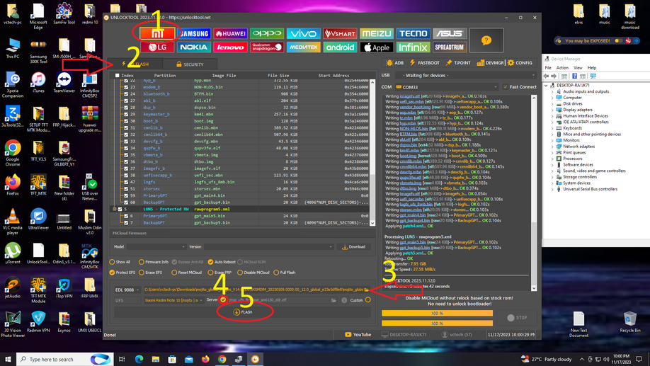

1.Open UnlockTool
2.Select Brand MI
3.Select FLASH
4.Select and Load FIRMWARE
5.Check Server
6.Click Flash

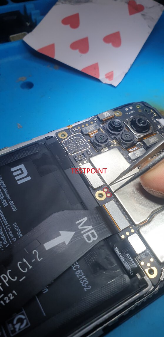

7.Go to phone: Testpoint and Conect Usb Cable and wait it done
view may SS
salamat po nawa'y makatulong
