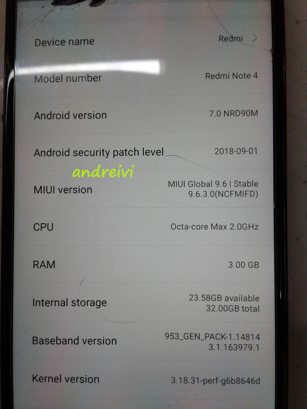

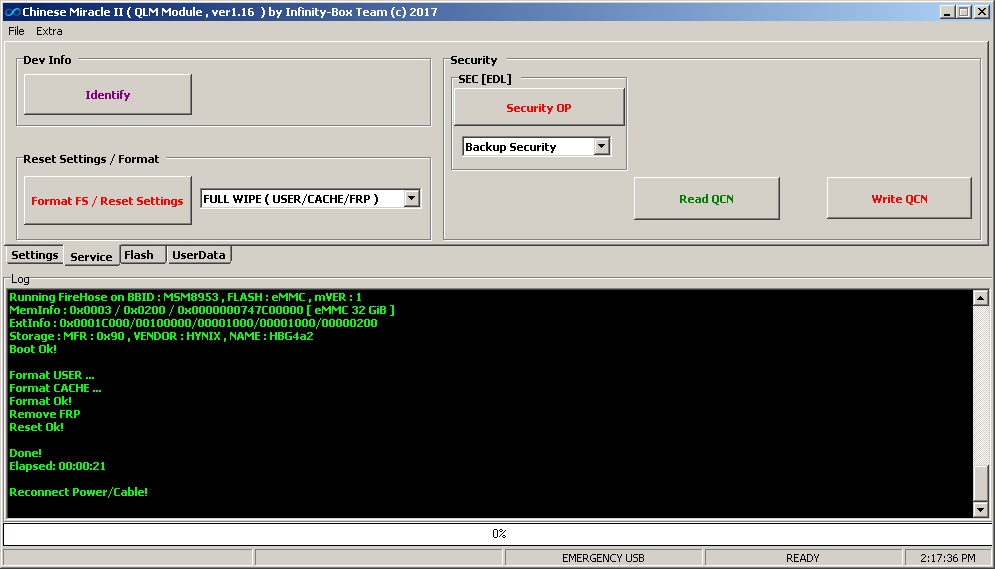

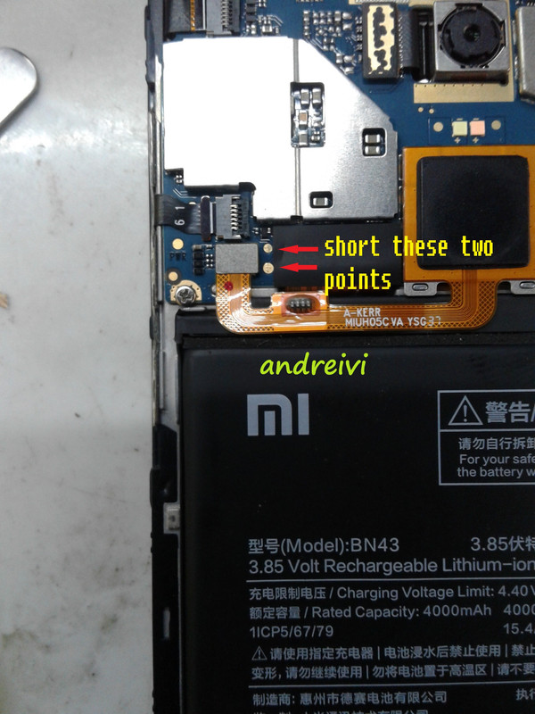

andreivi Expired Account Joined Jul 30, 2014 Messages 1,986 Reaction score 271 Points 381 Location Sison, Pangasinan/ Rosario, La Union Nov 22, 2018 #1 share lang mga amo Redmi note 4 done kay CM2 EDL Testpoint wag na ilagay yung baterya i-short mo sabay salpak ng usb Format FS/Reset Settings sa CM2 Finished product: Hti Thanks Button na lang kung nakatulong Sa yo
