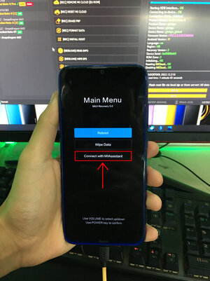

STEP 1: POWER OFF ANG UNIT THEN ENTER TO RECOVERY MODE SELECT MI ASSISTANCE SALPAK CABLE SA UNIT

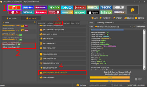

STEP 2: REMOVE MI ACCOUNT USING SIDELOADED SUNDAN LANG NASA PIC WAIT UNTIL DONE.

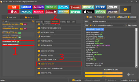

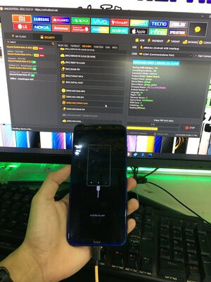

STEP 3: REMOVE FRP USING SIDELOADED, POWER OFF UNIT ENTER RECOVERY MODE SELECT MI ASSISTANCE SALPAK MUNA UNIT BAGO SUNDIN YUNG NASA PICTURE

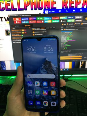

REDMI NOTE 8 MI ACCOUNT + FRP REMOVE DONE. SANA NASUNDAN NG TAMA ANG PROCEDURE.:D
