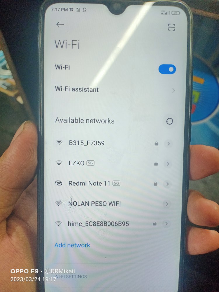

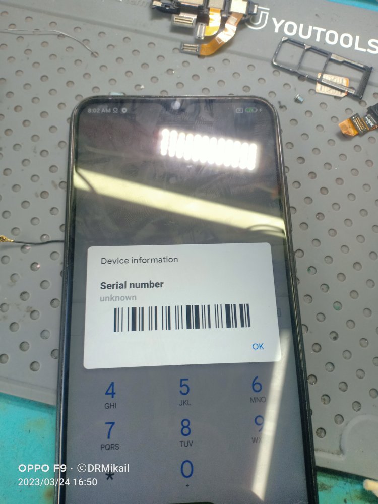

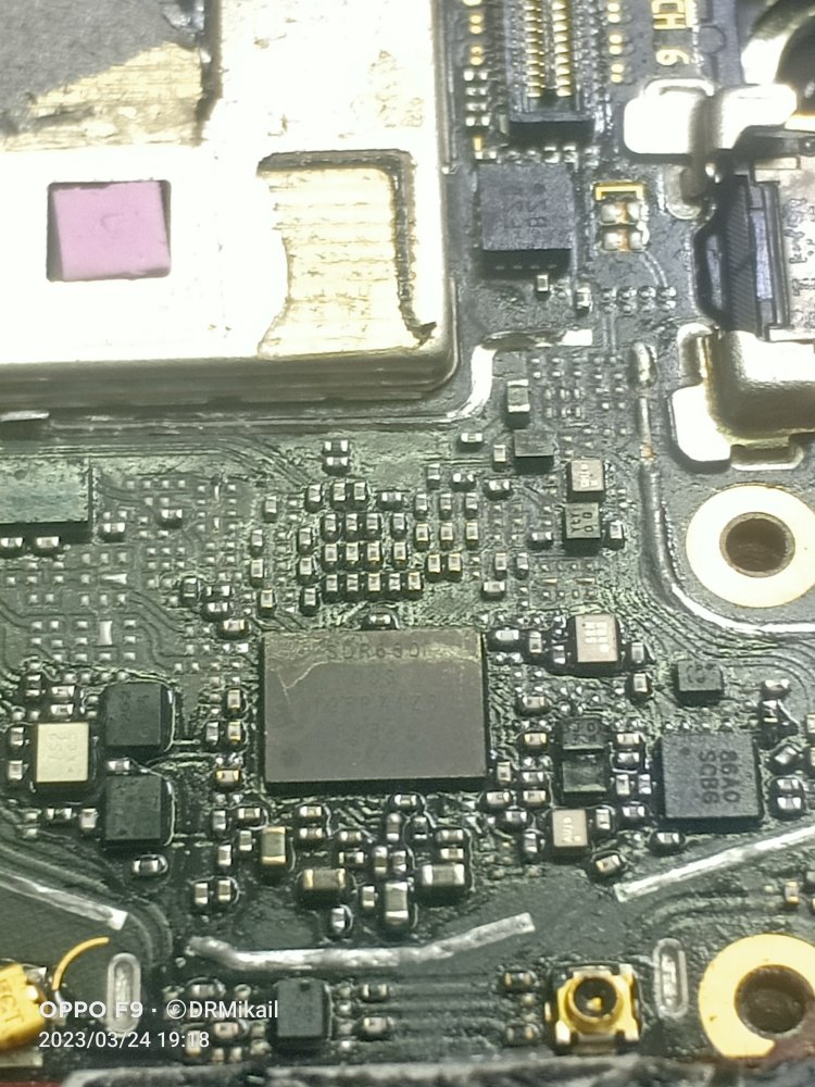

HISTORY:NASTOCK NA DAW YUNG UNIT THEN NAWALA YUNG WIFI AT IMEI PATAY SINDI REN SO JUMPER KO MUNA BATTERY FUSE TAPOS OKAY NA CHECK KO BASEBAND UKNOWN AT DIAL IMEI UNKNOWN REN DI REN NAKAKADETECT NG WIFI UNA FLASH KO SAME RESULT SO TINGIN AKO IDEA SA GOOGLE SDR660 PINALITAN SEE THE PIC MGA MASTER
PROCEDURE:

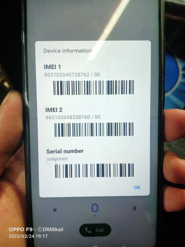

BAKLAS MOTHERBOARD THEN SA PAG ANGAT NG SDR660 360 INIT 4 AIR PAG LALAPAGAN NG BAGONG SDR660 350 INIT 2 AIR TADA SUCCESS SANA MAKATULONG SA INYO
SA SHOPPE LANG AKO NAGORDER NG PYESA HIT LIKE KUNG MAKATULONG :D
