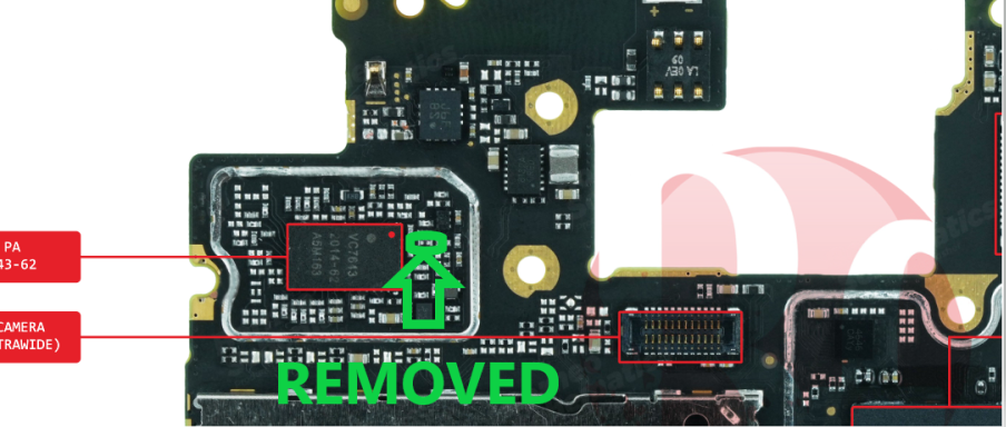

REFERENCE REDMI NOTE 9 AUTO OFF DONE VIA HARDWARE...
share ko lang mga bossing auto off problem pag open redmi logo tapos off na kaagad pero kapag naka fastboot di naman nag o off
ACTION: removed resistor

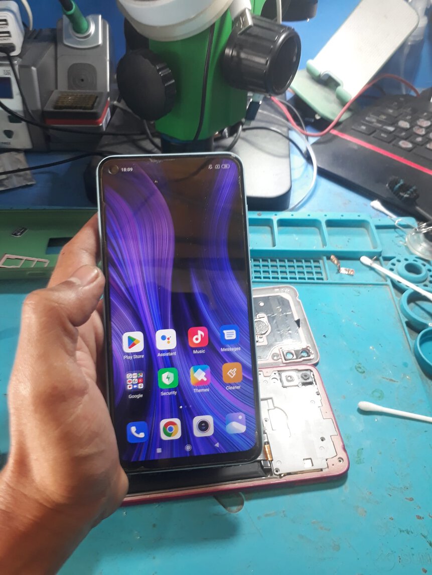

Tested today boss.. Working 100%.

3G P.A. YAN
PAG NA IINITAN YANG I.C. NA YAN NABUBUHAY ANG UNIT KAHIT WALANG I REMOVED DYAN
PERO NAPAKA SENSITIVE NYAN BALIK BALIK ISSUE DIN YAN PAG 3X REHEAT DEADS NA YAN
ANG LIKOD NYAN AY CPU AT EMMC
BETTER PALIT BAGONG I.C. DYAN
CONNECTED KASI YAN S C.P.U.
MILD REHEAT LANG SA GILID LANG.
PERO ANG TUNAY NA SALARIN DYAN AY ANG POWER I.C.
MAG KATULAD KASI NG POWER I.C. NG SAMSUNG NOTE 8 PLUS AT TECHNO SPARK 6 KE 7
PAREHONG MADALING MAPUNDI
ITO EXPERIENCE KO LANG PO SA REDMI NOTE 9 MERLIN AT SA MGA UNIT NA YAN
TNX PA DIN PO SA EFFORT BOSS
3G P.A. YAN
hindi ako gumamit ng hot air master soldering iron lang ginamit ko sinungkit ko lang ung resistor...pero goods naman until now ung unit..
