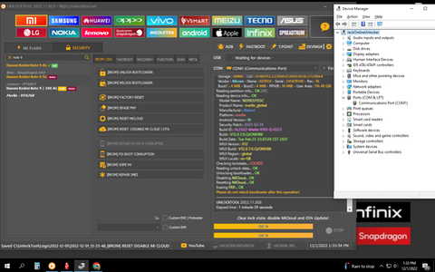

open Unlocktool
select mi
select security tab
select Redmi note 9 10x 4G model
select [BROM} reset I DISABLE MI CLOUD I OTA
hold vol up and vol down insert usb cable
wait until dote
open Unlocktool
select mi
select security tab
wait until done
https%3A//i.imgur.com/RansaMS.jpg[/img]']
tested saakin boss salamat sa procedure mo..
