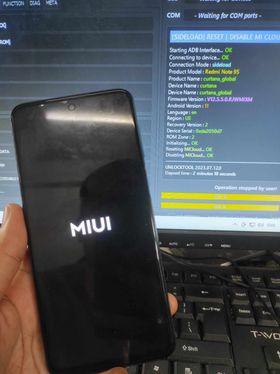

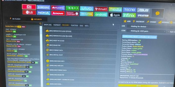

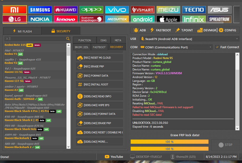

NOTE : gagana lang po sya sa miui 12 pababa pede siguro downgrade nyo muna
no need test point jan na po process sana makatulong
SELECT MI TAB
WAG NA SEARCH NAME NG MODEL DIRECT SELECT NA ANG RECOVERY

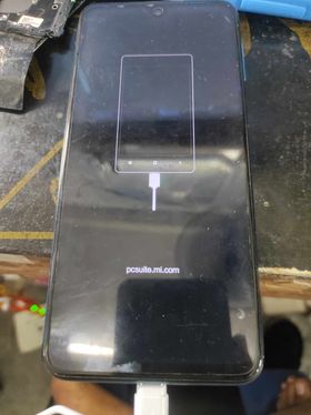

PUNTA KAYO SA RECOVERY MODE
HOLD VOLUME PLUS AND CONECT TO PC LALABAS NA MATIC ANG RECOVERY MODE
SELECT MO (MI ASSISTANCE)
THEN CLICK KANA SA UT NG (SIDELOAD) RESET l DISABLE MI CLOUD
JAN NA PIC WAIT MATAPOS ANG OPERATION
SANA PO MAKATULONG

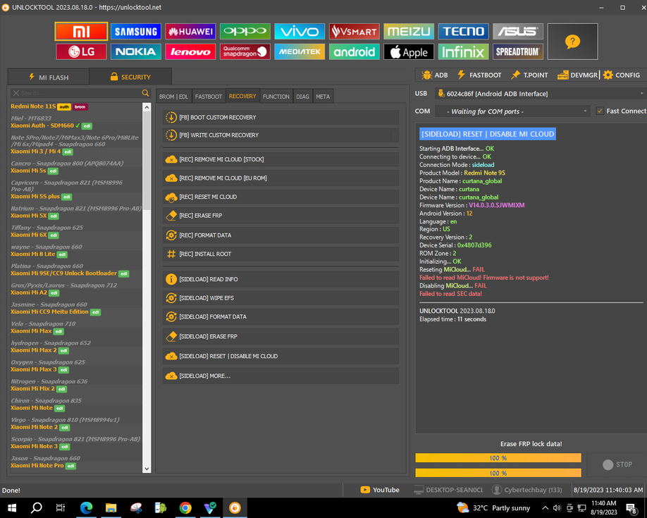

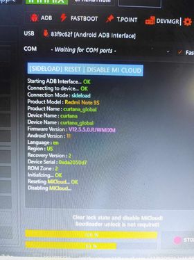

kaya po di nagana sa iba..
kasi naka Firmware version 14 na po kahit android 12 pa lang..
ung kaya ni unlocktool firmware version 12 at 13 lang na android 11 at 12 version..
kung titingnan nyo firmware version 12 pa lang kay TS .
sana makatulong
its means na update na yung mga d supported ni unlock tool.
SELECT MI TAB
SANA PO MAKATULONG
