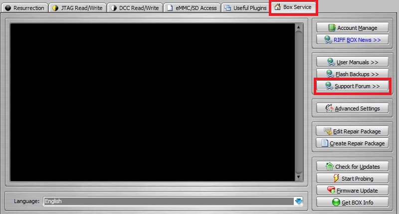

Important !!!
For urgent support and possible Servers access help, please use "Support Tickets" section on official support forum.
Simply click "Support Forum" on Box Service TAB.

Please click "Check for Updates" button to download newest set of repair DLL-s.

To download and install newly released updates, start RIFF JTAG Manager, go to Box Service TAB and click "Check for Updates" button.

To download and install updates, click "Check for Updates" button on "Box Service" tab.

  • To download new files two methods can be used:
- Automatic method by JTAG Manager -> Box Service -> Check for updates (FTP protocol)
- Manual method via web browser: Index of ../../RIFF/RIFF_ROOT/
In case that for any reason FTP protocol is blocked, please use manual method and download files via web browser.
