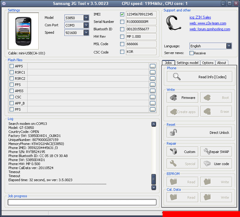

READ PHONE INFO KO SA Z3X BUT NO LUCK
TRY KO PANG IBANG SOLUTION PERO AYW TALAGA...

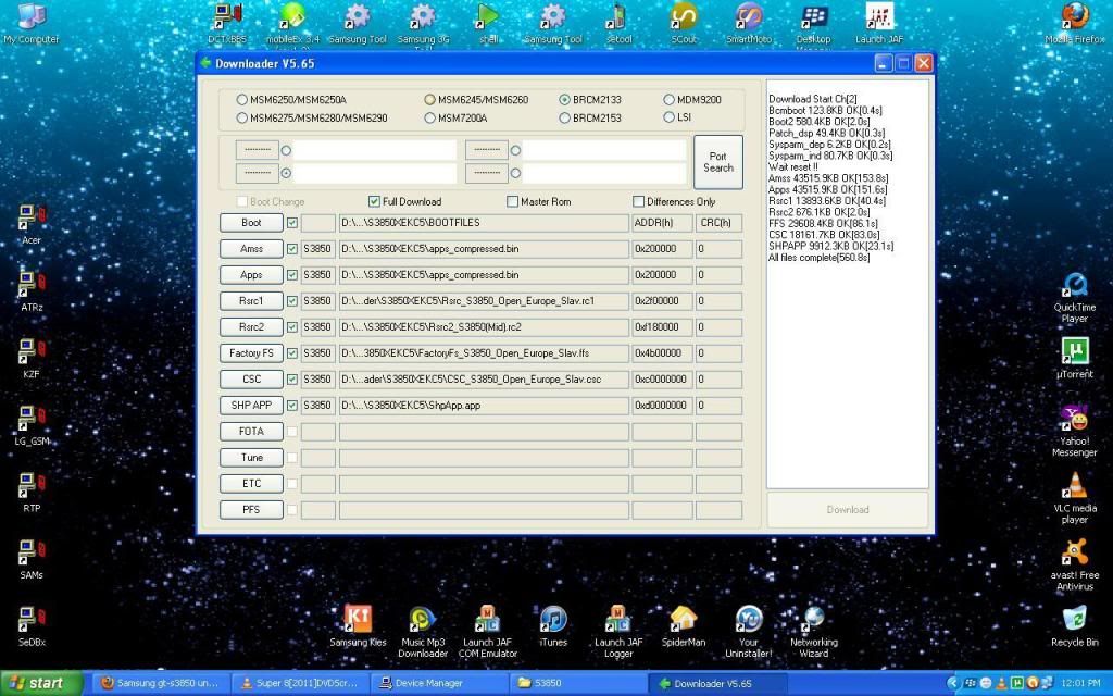

ACTION: FULL FLASH USING DOWNLOADER
PROCEDURE
1: INSTALL USB DRIVER/http://www.sendspace.com/file/rf6jwp
2: OPEN DOWNLOADER OR FLASHER/http://www.megaupload.com/?d=L3VEWLP0
3: ADD FILE/http://www.sendspace.com/file/qaui12
4: CLICK PORT SEARCH
5: THEN CLICK DOWNLOAD
DONE

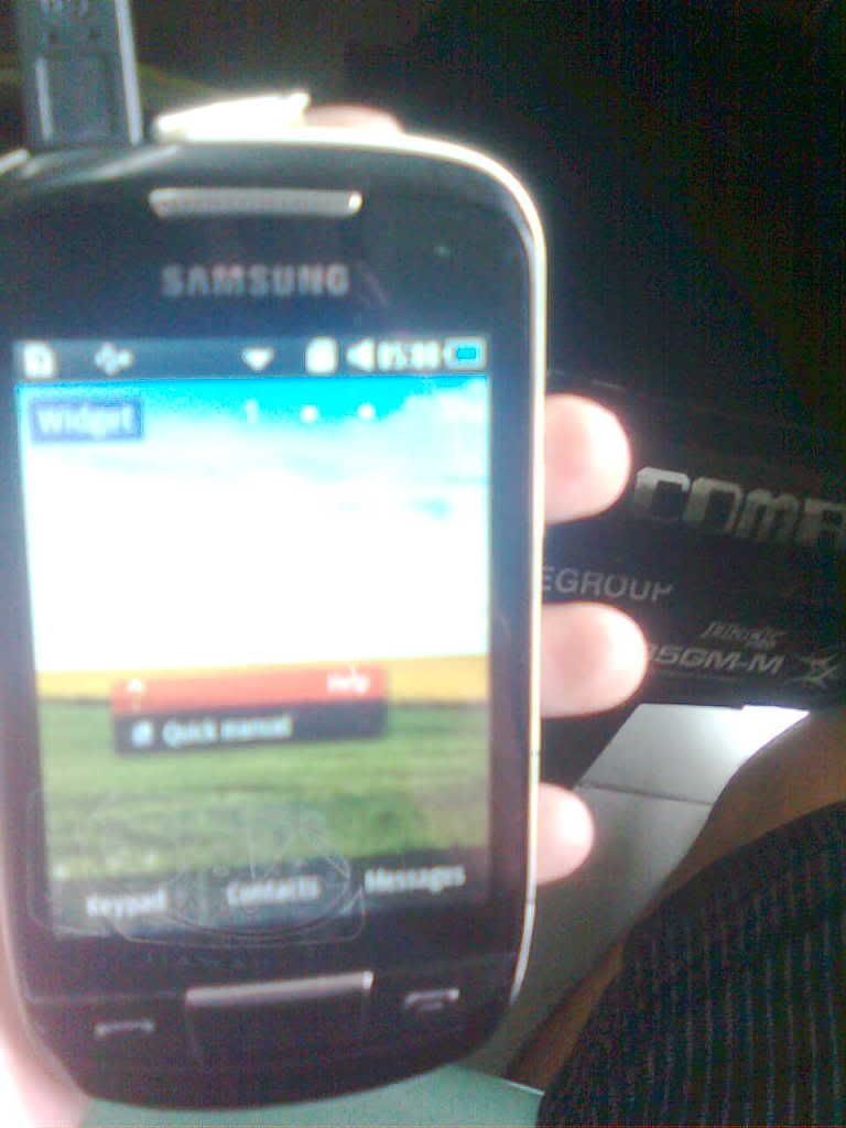

750 LANG PO MGA AMO
AYOS MY PANG XTRAY N SI ESMI NITO
