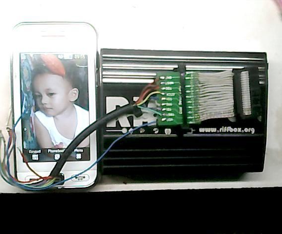

BASTA NA LANG DAW DI NAG ON
TRY KO REPAIR BOOT SA Z3X NO LUCK
TOOL'S
RIFF BOX
E210 CABLE --> USB ONLY

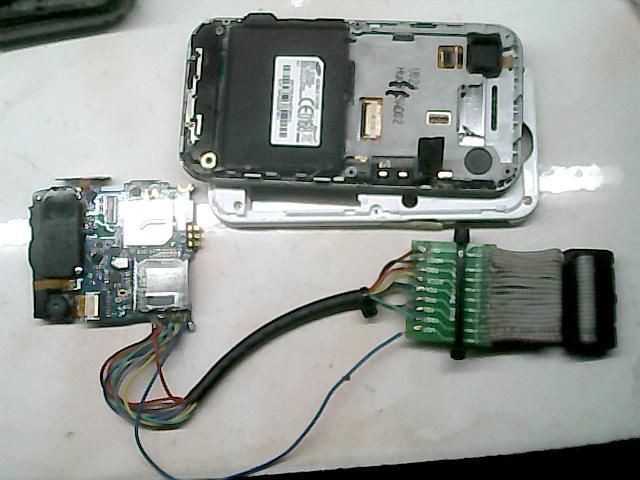

PROCEDURE'S

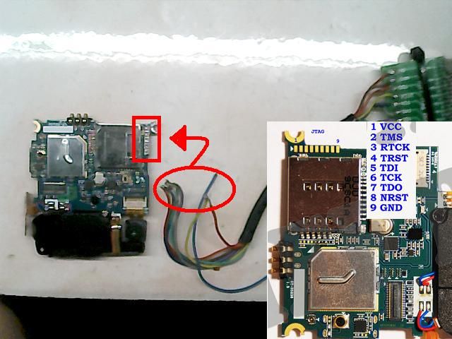

To resurrect Samsung S5230 do this:
Solder JTAG cable to S5230 JTAG pads;
Connect USB cable to phone and PC;

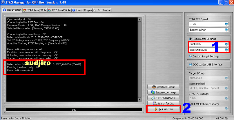

Make sure Samsung S5230 is selected in the list of models
Click Resurrect button;
Wait few seconds until software signals a successful operation completion;
Disconnect USB cable, de-solder JTAG wires
