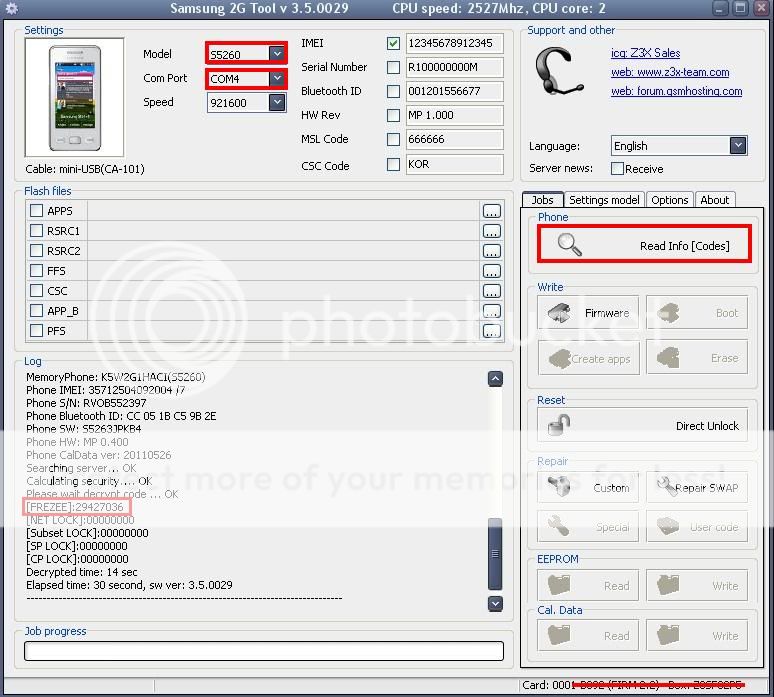

S5263 Star II Phone Lock Done w/o Flashing
Tool's
- Z3X Samsung
- CA-101 Micro Usb Cable
Procedure
- Open Samsung 2G Tool
- Select S5260 Model
- Click Read Codes
- Enter Frezee Code
- Phone Lock Solved
Quote:
Note install kies first!
