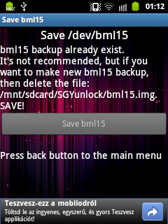

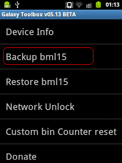

Backup nyo po muna yung bml15.

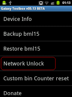

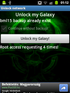

Back, then select NETWORK UNLOCK tapos select UNLOCK MY GALAXY
UNLOCK DONE..
