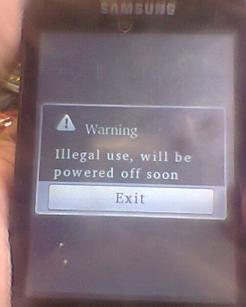

S5570 SPD 6800H warning illegal use,,will be powered off soon pag nilagyan ng sim,,,,,,

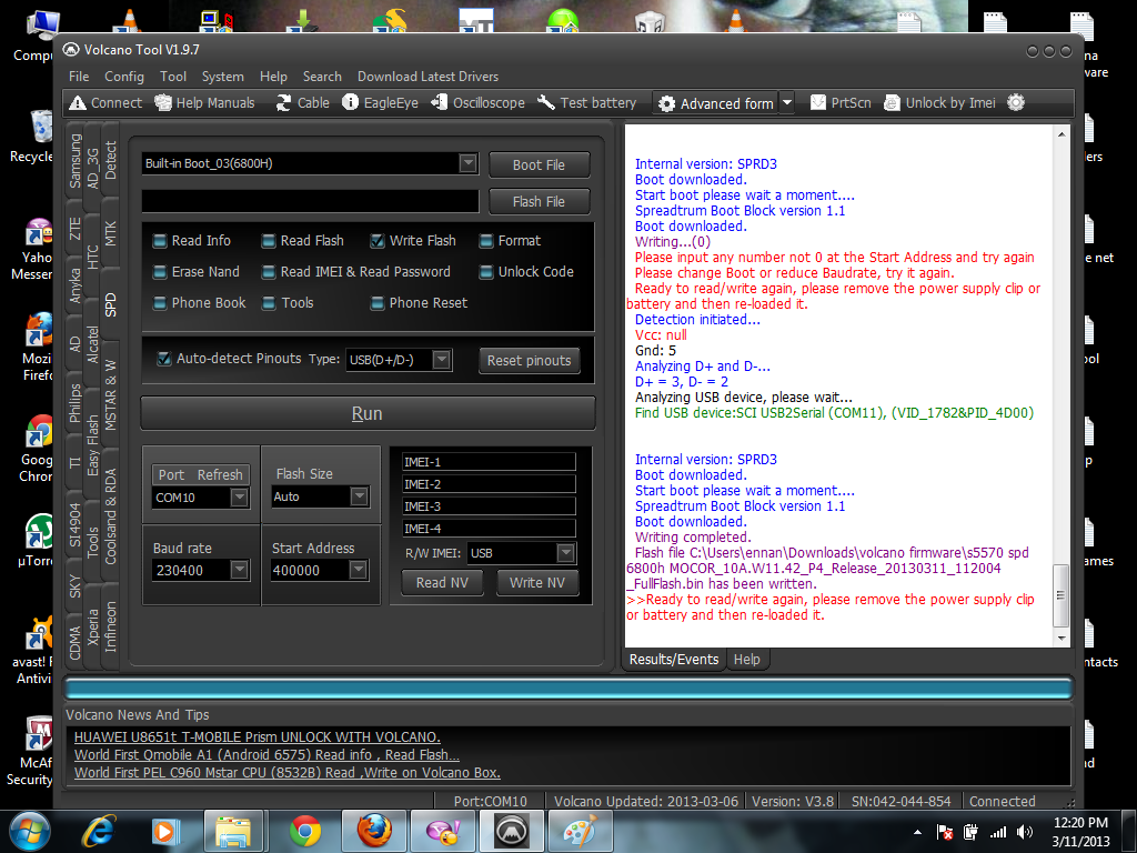

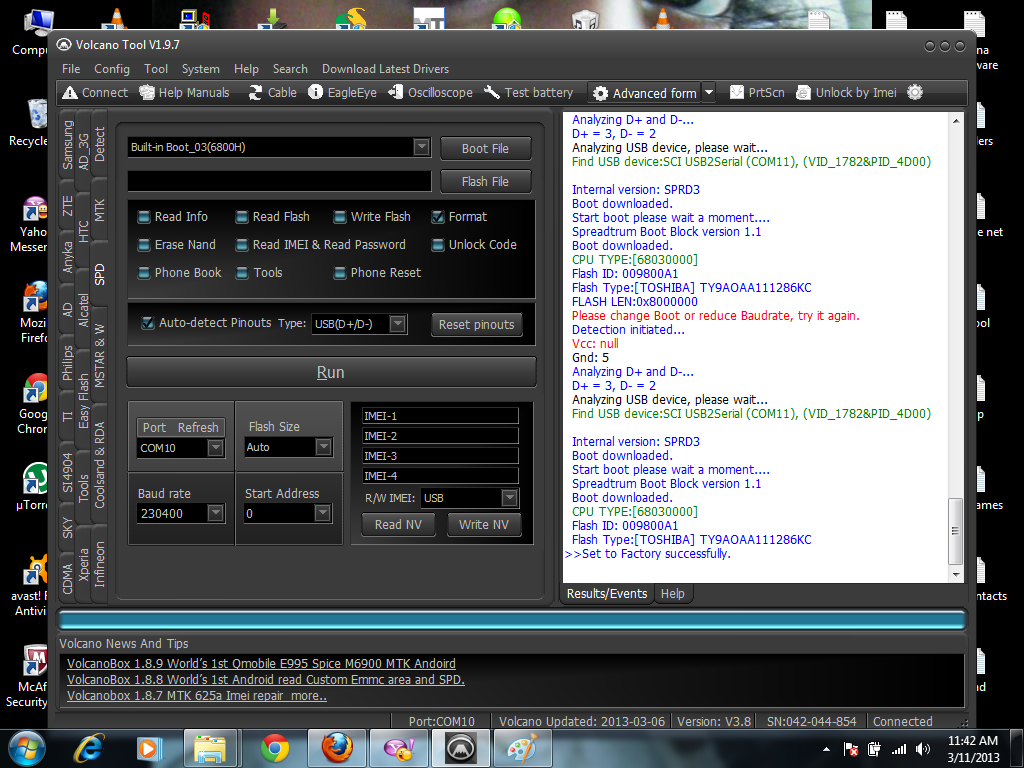

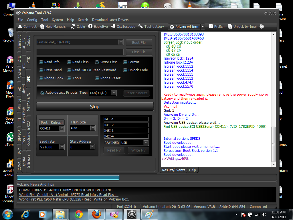

solution,,,tirahin kay volcano
open volcano tool
tick spd tab select correct boot(6800H)
tick read flash tapos run para maback up
habang inaantay matapos search muna ng good back up kaso wala makitang kaparehas na chipset :-O:-O kaya ung back up na lang ulit ang ginamit ko
tick write flash then select yung back up nya
tapos mgwrite tick format then run tapos maiformat ibalik ulit ang back up nya at antayin matapos,,,pag may problema sa pagbabalik ng back up,,,check lang yung address

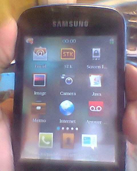

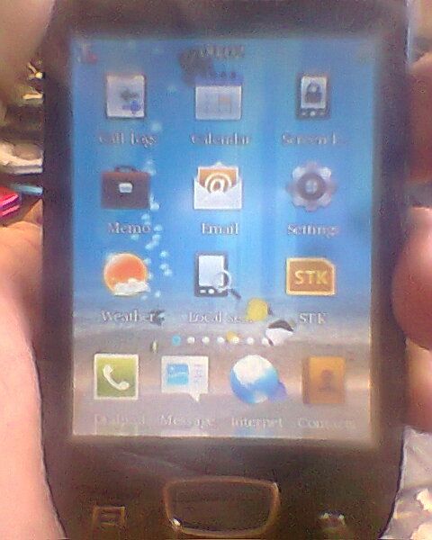

Click this bar to view the full image.

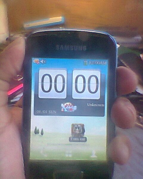

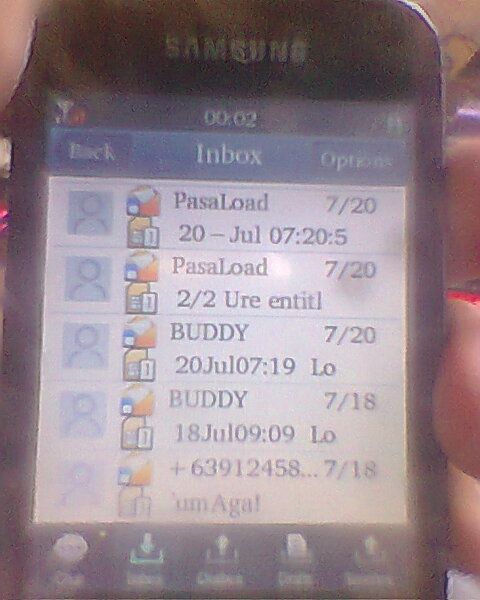

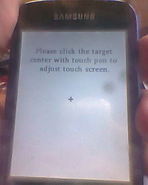

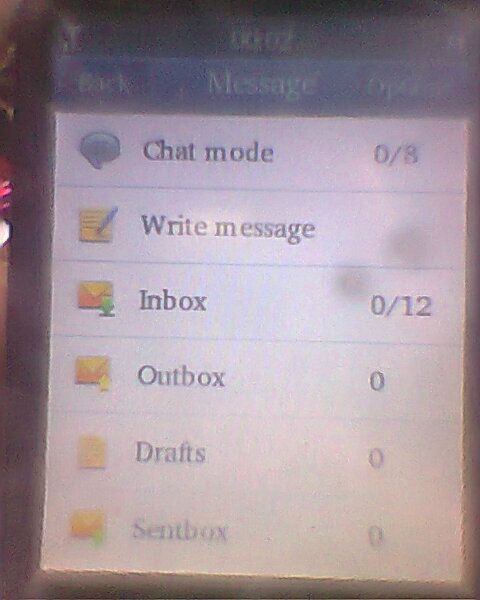

try nmn ng may sim
ok na,,
