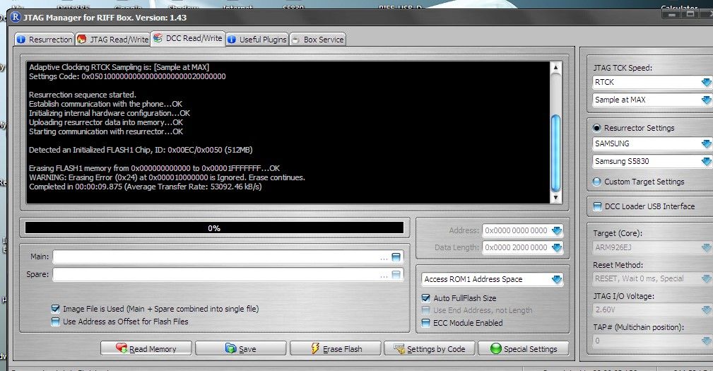

Procedure:
Jtag cable to S5830 pcb board ..
Connect USB cable to unit ..
Connect battery or Power supply to unit..
make sure S5830 is selected in the list of models..
Click resurrect Button..
Wait till software is Done..
and disconnect usb cable and de-solder jtag wires

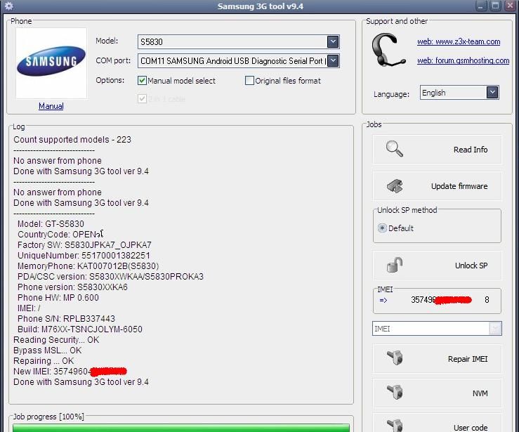

program ko dumpfiles done
sunod repair ko imei niya sa z3x ayus bumalik na ang dati nyang imei.
1 - Z3X
2 - Program Samsung 3G tool v9.4
3 - Enter code * # 7284 # - usb phone choise. Then restart the phone
4 - Connect the USB cable and driver all intall
5 - Write a new imei and click Repair Imei.
resurrection

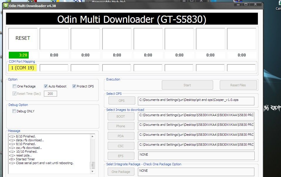

flashing dumpfiles
pagkatapos hanggan samsung logo lng flash naman sa odin
repair na ako imei sa z3x salamat di ako pinahirapan..

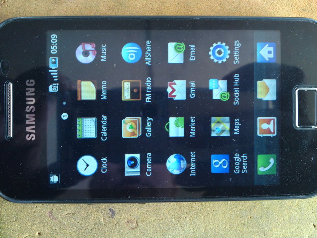

ito na finish unit at maraming salamat kay boss delax di niya ako pinabayaan hanggan matapos
lupit talaga ng master ko hehehe sa uulitin mga boss...
