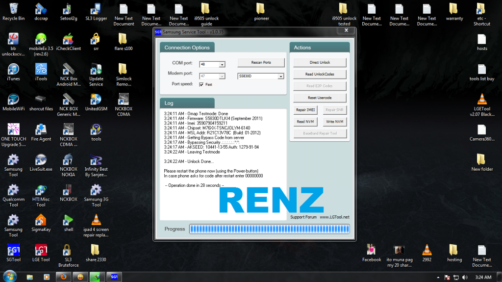

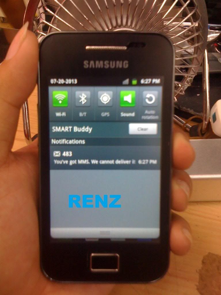

S5830 unlock done using se tool
tools:
se tool activated
usb mini cable
procedure:
enable usb debugging
open SGTOOL
choice correct model
connect s5830 to pc using usb mini cable
install driver if needed
click rescan port
click unlock
screenshot:
