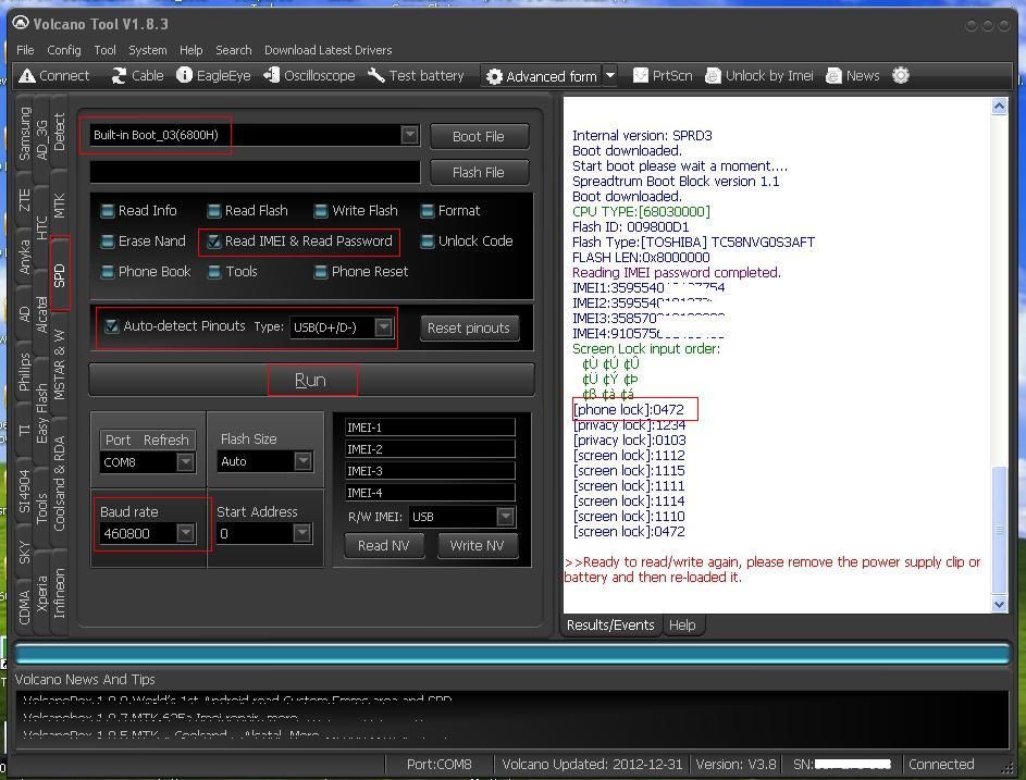

s6500 spd read code by vulcano
unit: clone s6500
chip : spd 6800h
status : lock code
tools
vulcano box
jig P-07A
procedure
1. connect vulcano box open GUI
2. select spd tab boot 6800h
3. set baud rate 460800
4. check auto detect pinouts USB (D+/D-)
5. check ream IMEI and read password
6. run
DONE!
Click this bar to view the full image.
for reference only
