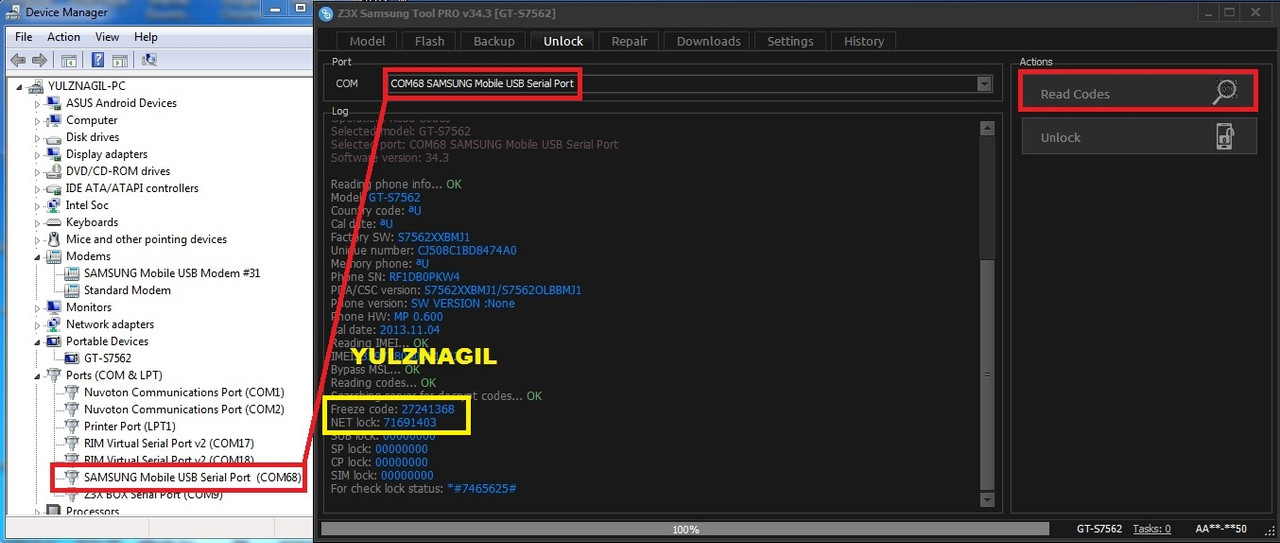

REFERENCE s7562 unlock done with z3x

READ CODES
Code:
 USB cable:
  1. Phone must be powered on.
  2. Type *#7284# and choose phone USB.
  3. Type *#197328640#, select: Common - Diag Config - USB diag.
  4. Reboot phone.
  5. Connect USB cable, install drivers.
  6. Select diagnostic port in port settings.
  7. Press 'Unlock' button for direct unlock or 'Read codes' to read security codes.
SELECT CORRECT PORT
PUT SIMCARD ENTER NET lock 8 digits and your done
