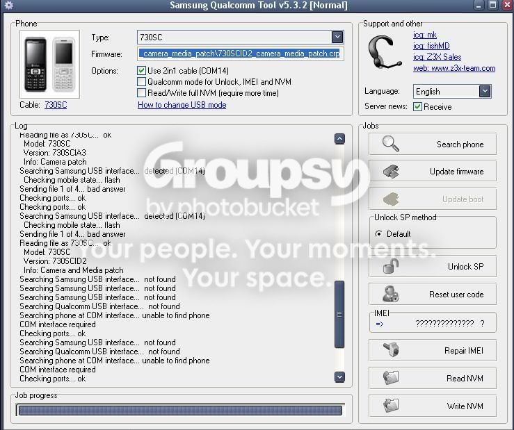

Tools:
Z3x samsung 730sc 2 and 1 combo
Procedure:
Install Usb driver [C:\Program Files\Z3X\Samsung\Qualcomm]
unlock [normal mode rj45 & Usb]
After unlock:
boot mode : [HOLD * # + POWER]
Install usb [C:\Program Files\Z3X\Samsung\Qualcomm]
in case na ayaw ma install try this: [TBT Driver Qualcomm]
path file use :
[730SCID2.crp] and [730SCID2_camera_media_patch.crp]
usb install screenshot:
unlock screen hot:
patch Camera:
wella:
logs:
Code:
Reading file as 730SC... ok Model: 730SC Version: 730SCIA3 Info: Camera patch Searching Samsung USB interface... detected (COM14) Checking mobile state... flash Request error! Searching Samsung USB interface... not found Searching Qualcomm USB interface... not found Searching phone at COM interface... unable to find phone COM interface required Searching Samsung USB interface... detected (COM14) Checking mobile state... flash Searching phone at COM interface... unable to find phone Normal mode required Searching Samsung USB interface... detected (COM14) Checking mobile state... flash Sending file 1 of 4... bad answer Reading file as 730SC... ok Model: 730SC Version: 730SCID2 Searching Samsung USB interface... not found Searching Samsung USB interface... not found Searching Samsung USB interface... detected (COM14) Checking mobile state... flash Sending file 1 of 4... sended Sending file 2 of 4... sended Sending file 3 of 4... sended Sending last file... sended Flashing done (time - 12:03:08 AM)
Code:
Searching Samsung USB interface... detected (COM14) Checking mobile state... flash Sending file 1 of 4... bad answer Checking ports... ok Checking ports... ok Searching Samsung USB interface... detected (COM14) Checking mobile state... flash Sending file 1 of 4... bad answer Reading file as 730SC... ok Model: 730SC Version: 730SCID2 Info: Camera and Media patch Searching phone at COM interface... unable to find phone COM interface required Checking ports... ok Searching Samsung USB interface... not found Searching Qualcomm USB interface... not found Searching phone at COM interface... unable to find phone COM interface required Checking ports... ok
information after unlock:
* text and call
* camera working [save and not hung]
* working 100% tsamba mode
