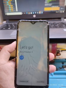

First baklas back cover para sa testpoint

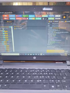

Open unlocktool
Select samsung click samsung A01
Testpoint salpak usb cord
Then click edl Erase Frp

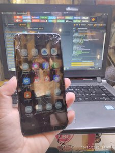

Anatayin hanggang matapos
