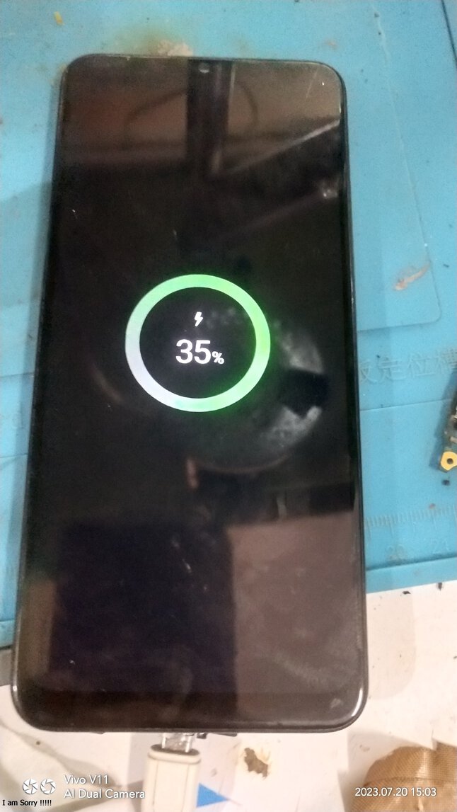

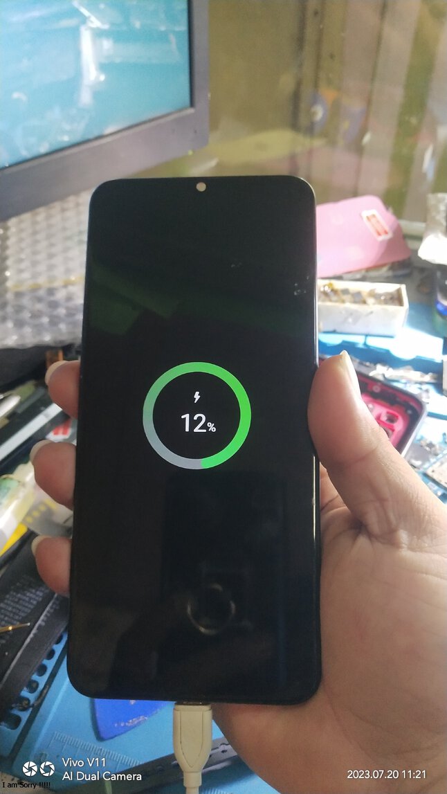

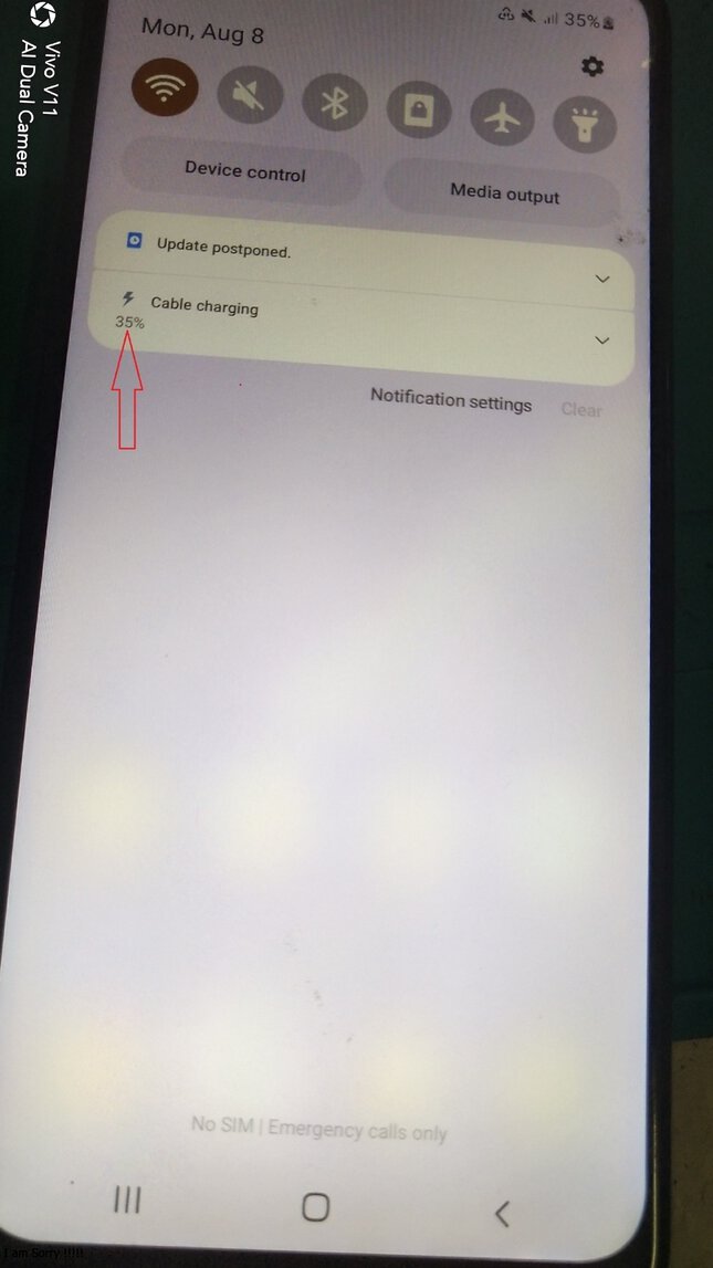

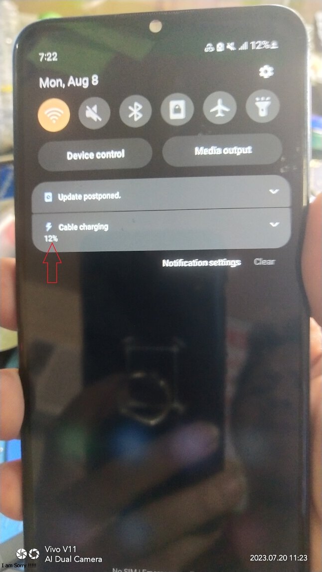

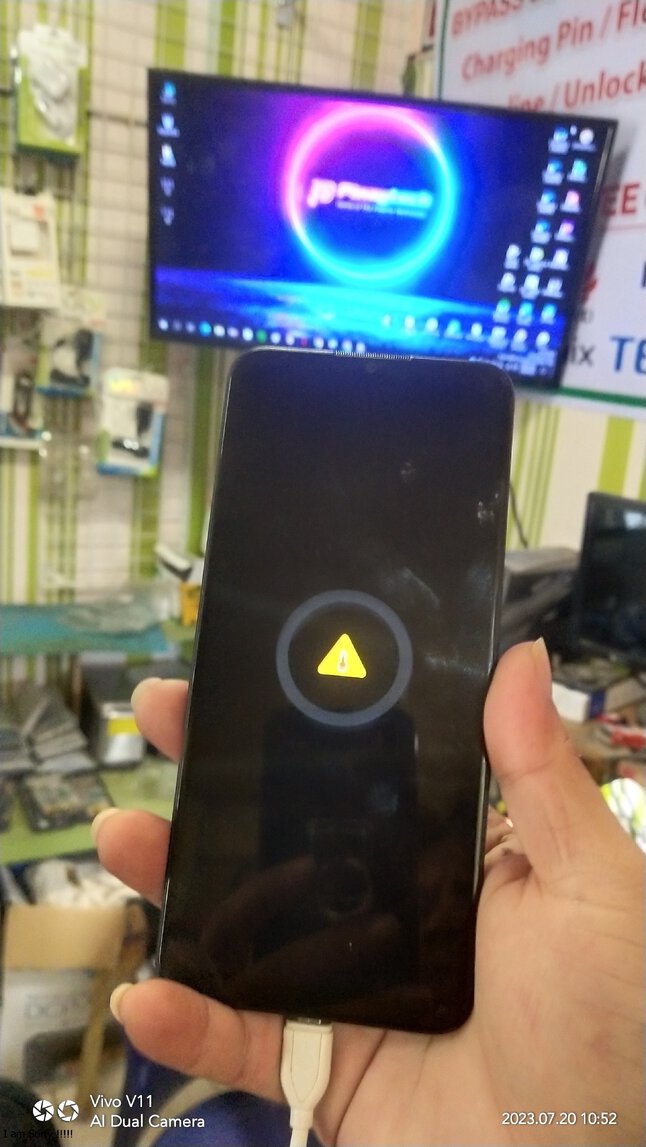

from cotech..
naubos na nila charging board same issue... :D :D :D
Status
Procedure

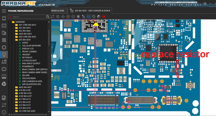

e check si 1.8v sa battery terminal while charger plug in..
at yun nga missing si 1.8v sa BAT TEMP connection..
solution replace resistor galing mismo sa same unit..
and done...
puro charging board at linis lang kay google at youtube.. :D:D:D
