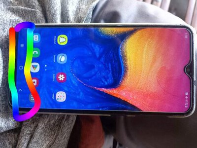

RonilleJames06 Registered Joined May 16, 2019 Messages 81 Reaction score 12 Points 1 Location San Antonio Nueva Ecija Dec 10, 2022 #1 Nachange ako lcd okey Naman sya tapos biglan nagsoftware update after nun ayaw na matouch nang back botton at home botton.. Please mga sir Attachments received_554640723174445.jpeg 42.3 KB · Views: 1
activa2r Administrator Staff member Joined Oct 30, 2022 Messages 714 Reaction score 2,665 Points 241 Location Leganes , Iloilo Dec 10, 2022 #2 ganyan sakit ng samsng once mapalitan ng lcd lalo na pag class a.. solution is hanap ng orig or downgrade firmware..
RonilleJames06 Registered Joined May 16, 2019 Messages 81 Reaction score 12 Points 1 Location San Antonio Nueva Ecija Dec 10, 2022 #3 T -=activa2r=- said: ganyan sakit ng samsng once mapalitan ng lcd lalo na pag class a.. solution is hanap ng orig or downgrade firmware..thanks done okey na sir reset lang Ang kailangan Click to expand...
