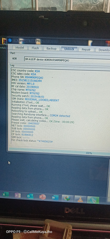

Gandang araw mga master share koalng gawa ko
Unit : a107F
Status : Lock to all network
Procedure : Readcode via z3x no need root no need credit
- enable oem unlocking % usb debuging
- dial *#0808# select dm+acm+adb
-open z3x select model a107f
-insert usb cable install driver f needed
-click read code
at hintayin matapos
Salamat sana maka tulong po<<

Maraming Salamat boss kaya Pala ayaw gumagana set Pala ang adb mode kaya ayaw mag read codes malaking tulong boss ngaun pa ako nka try unlock A10s galing saudie.
