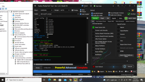

Procedure:
Open hydra tool MTK module, Select brand Samsung, Select model SM-A107F (A10s)
Check: auto brom exploit, Check: force (preloader to brom) Click boot info
Hold volume down then salpak usb cable, After ma read info, Go to and click PM tab
Click partitions, Check Persistent, Click erase, Hintay sandali Done!!!
Sana Makatulong, Keep Safe!!!
