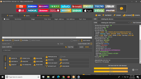

Samsung A10S SM-A107f FRP done via Unlocktool no TP/Alliamce
- run unlocktool latest version
- elect mediatek
- select mtk universal
- click erase frp
- connect phone in normal mode to pc
- power off the phone --- no bootkey na
-phone detected and software runs auto
=Sasmsung A107F A10S FRP eRASE fRP NO BOTKEY UNLOCKTOOL - MEUH.pngwait till done
- elect mediatek
- click erase frp
=View attachment 8540wait till done
