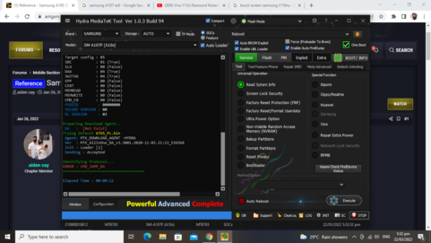

step 1 -select brand : Samsung
step 2 -model: SM-A107F (A10s)
step 3 -mark: auto brom exploit
step 4 -mark: force (preloader to brom)
step 5 -click boot info
step 6 -hold volume down then salpak usb cable
After ma read info....
step 7-navigate PM tab
step 8 -click partitions
step 9 -mark Persistent
step 10 -click erase
then REBOOT !!!!
ALL DONE !
Sana po makatulong :)
bos tanong lang,ung procedure mo b kasama n doon un password?kasi ung tanggap ko wala siyang hr na try ko tut mo pero andun pa rin password hndi natanggal...
