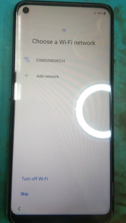

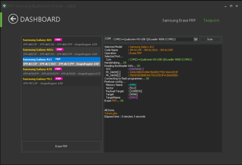

share ko lng mga boss samsung a11 frp bypass gmit freetools android 11 binary 2
download this tool first
LINK

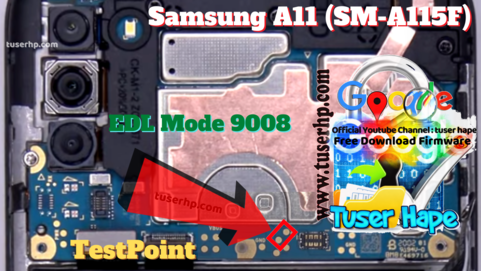

steps:
1)open the tool select erase frp
2)select A11
3)open unit for testpoint
4)open device manager
5)install qualcomm drivers if needed mdmi nmn sa gowgels search nlng po
6)testpoint unit (check pix po or sa tool meron din)w/out battery po yan
7)salpak usb cable s pc dpt mdetect sa device manager ung qualcomm
8)scan com port sa tool
9)click erase frp
10)wait lng mtpos and ur done sabay kabit battery na magrestart ng kusa yan if pumunta ng recovery reboot lng po
thanks sana makatulong to sa inyo mga boss

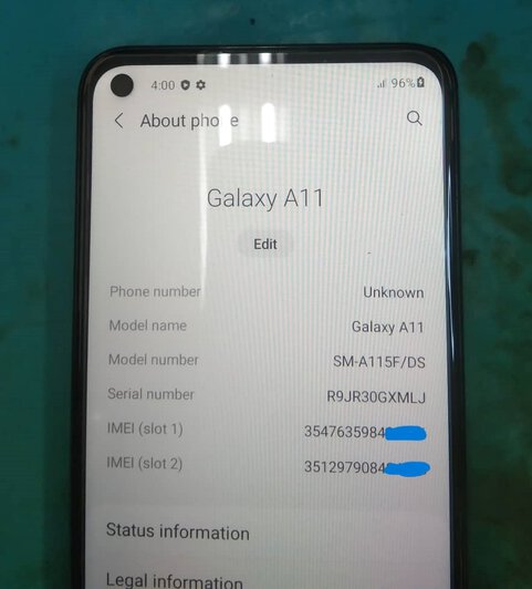

eto po pix pki check nlang po

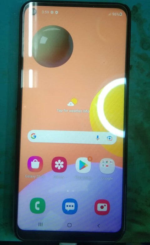

tested nga po sya...need lang ng testpoint..
pero tested..

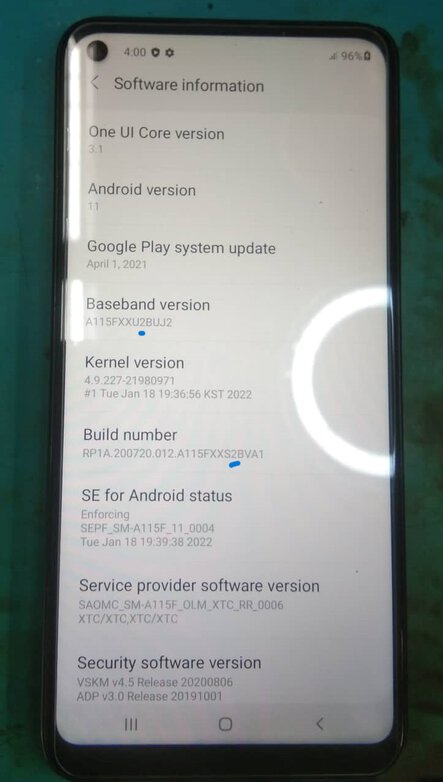

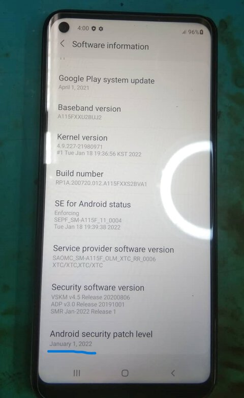

patch level
April 1, 2022

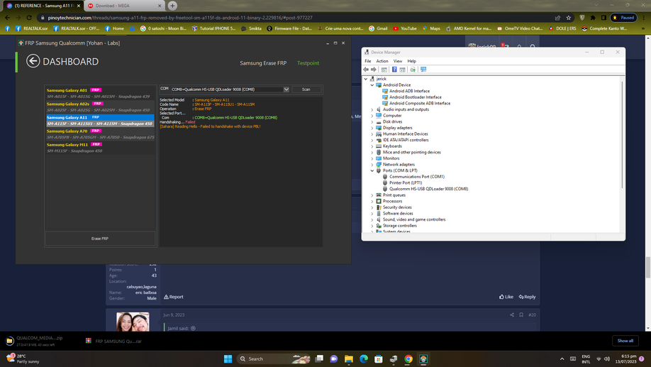

salamat boss tested sakin
Salamat bossing working as of November 28,2023
