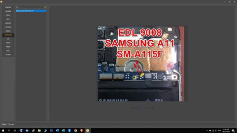

1. Open the back cover
2. Remove battery from connection

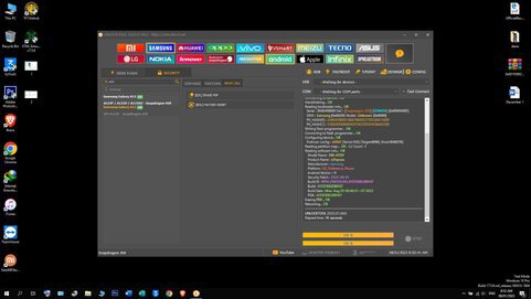

3. Click samsung tab & search A11
4. Click brom edl

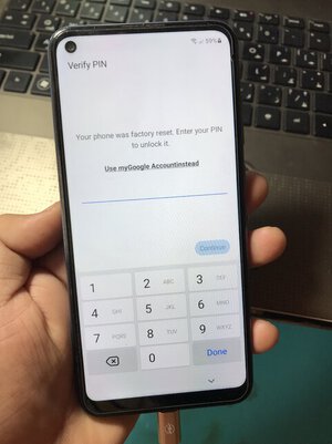

5. Click factory reset pag hindi pa nareset or click erase frp pag nareset na
6. TP & insert cable hintayin hanggang sa matapos

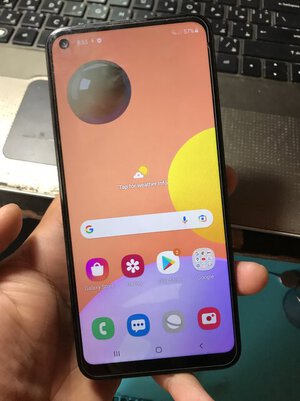

7. Connect battery & manually turn it on
8. Done
