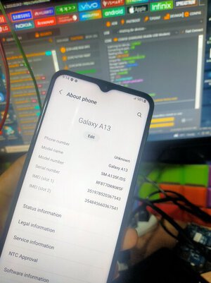

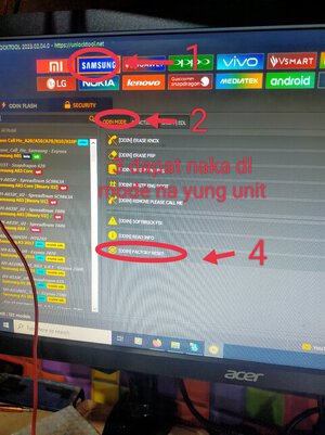

First open unlock tool
Select Samsung tab
Select ODIN MODE next take your phone to download mode and select [Odin]factory reset. Pagkatapos ma reset Wala na frp
P.S Ginawa ko pag download mode binaklas ko battery at binalik, tapos hold and press volume up and down at inject yung cord wait lang mag dl mode..

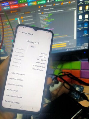

thanks tested kaso nakakakaba kasi de kusang mg restart but atlest successfull
