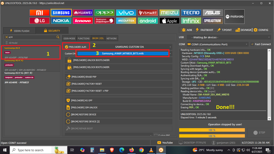

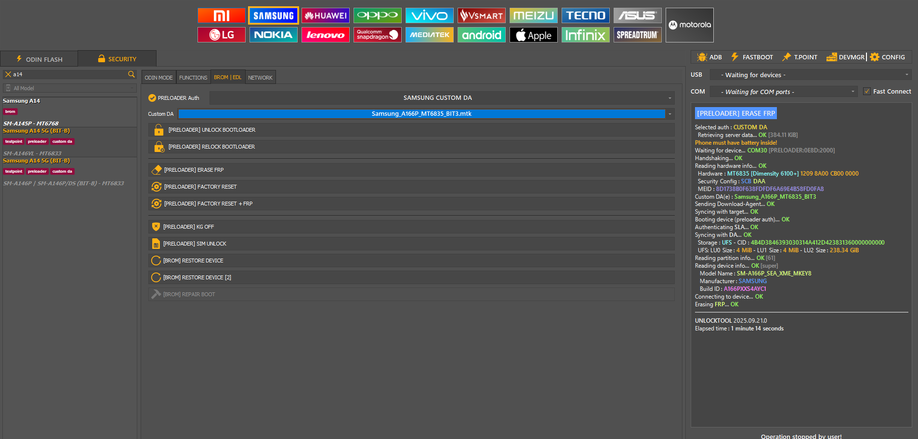

Procedure:
1. Power on phone then i-connect ang cable to pc
2. Open Unlock Tool
3. Select Samsung tab
4. Sundan yang nasa image
5. Click [Preloader] Erase FRP
6. Turn off phone
Madedetect na sya, hintayin nalang matapos
Done!!
