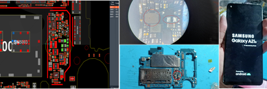

Mga dol for reference.. No display / No backlight
Ayaw mabuhay yung binigay ni tomer.
1st: Check basic saksak schematic USB Nagkakarga
2nd: Baklas unit check battery voltage (Drain battery) Shocktest
3rd: May karga na battery, Power On vabrate lang.
4th : Use flash light. Ayun kita may Logo.
5th: Baklas unit gmit tester kita s likod saralin. Semi shorted yung Caps
Replace yung Caps at yung Coil., Ayun may display na.
Thanks..sana makatulong.
