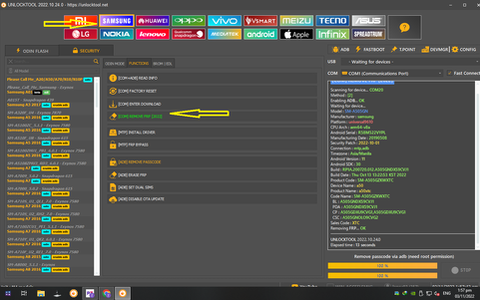

2nd Open unlock tool
select samsung
select Functions tab
select [COM] REMOVE FRP

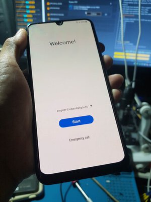

DONE PO SANA MAKATULONG SA NEWBIE NA KAGAYA KO :)
