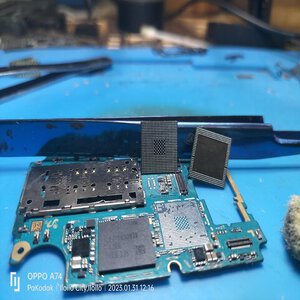

MODEL : Samsung A50s
PROBLEM : NO POWER
HISTORY : Naghahang pa sa LOGO, pinabayaan ng Costumer ng ilang araw at nagNo power na lng
Basic steps muna upon checking,
>>Check battery volatage = NORMAL
>>Check Mother Board = No Shortage/Leak Found
>>Voltage and amperes detection sa power supply = 0.216 something lang Nothing more and less
So I decided na CPU tama
WORK DONE : CPU RAM REWORKS
(Baklas CPU settings)
Hot Air Temp: 400
Air Flow: 40
(Balik CPU Settings)
Hot Air Temp : 380
Air Flow : 40
Solder Paste 183

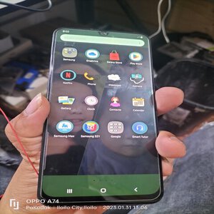

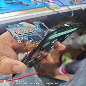

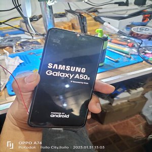

After nalagay ang RAM and CPU,
Umandar na po at buhay na unit and all functioning well...
Maraming Salamat po..
Sana makatulong;););)

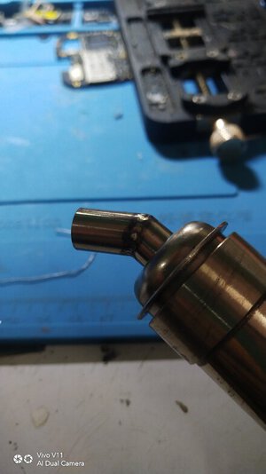

Anu gamit hot air mo boss
bigyan kita tips boss..
wala po yan sa init at hangin..
ang pinaka importante po boss kilalanin mo hot air mo.. alamin mo capacity nya.. sa araw araw na ginagamit natin pakiramdaman mo..
kasi pag mag base ka sa brand iba iba performance.. tulad sa akin gamit sugon pero may adjustments kami..
ito halimbawa ung nozzle namn namin modified..
yan po ay tips para di ka gumastos kasi nalaman mo magamda pala ung brand na gamit..
