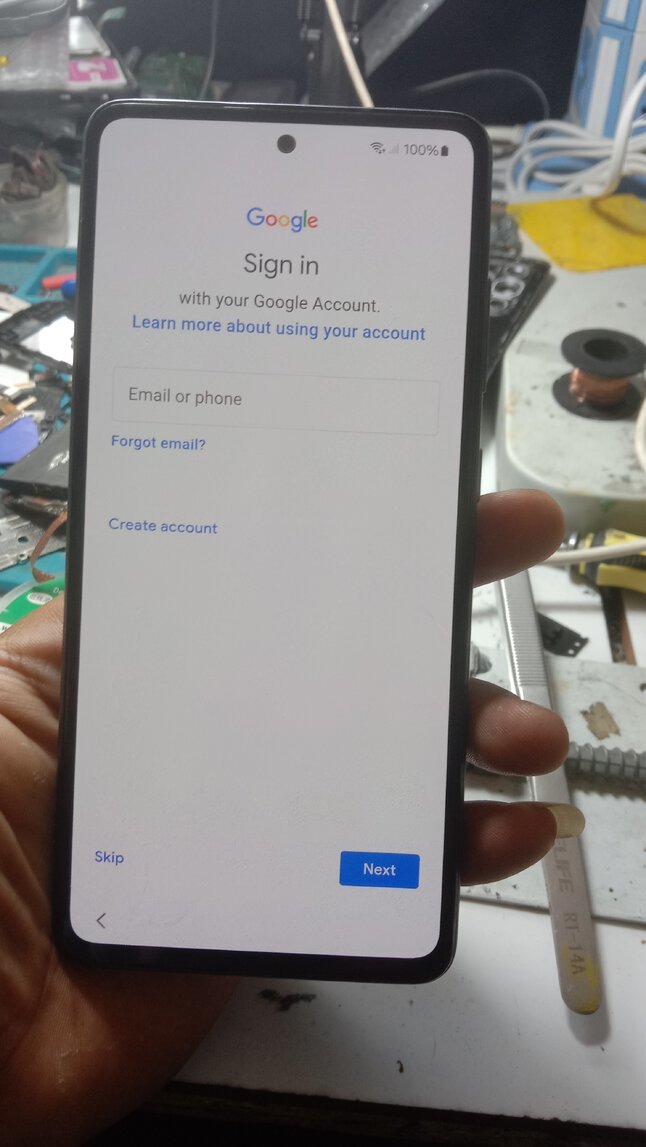

ibahagi kulang .itong tangap ko na samsung a52s 5g dala ni tumer sakin naka frp na .pero .kong naka pass ang unit.kaya din reset natin.ganito hold v- at power switch.sabay salpak charger...
Frp.ito na ginawa ko

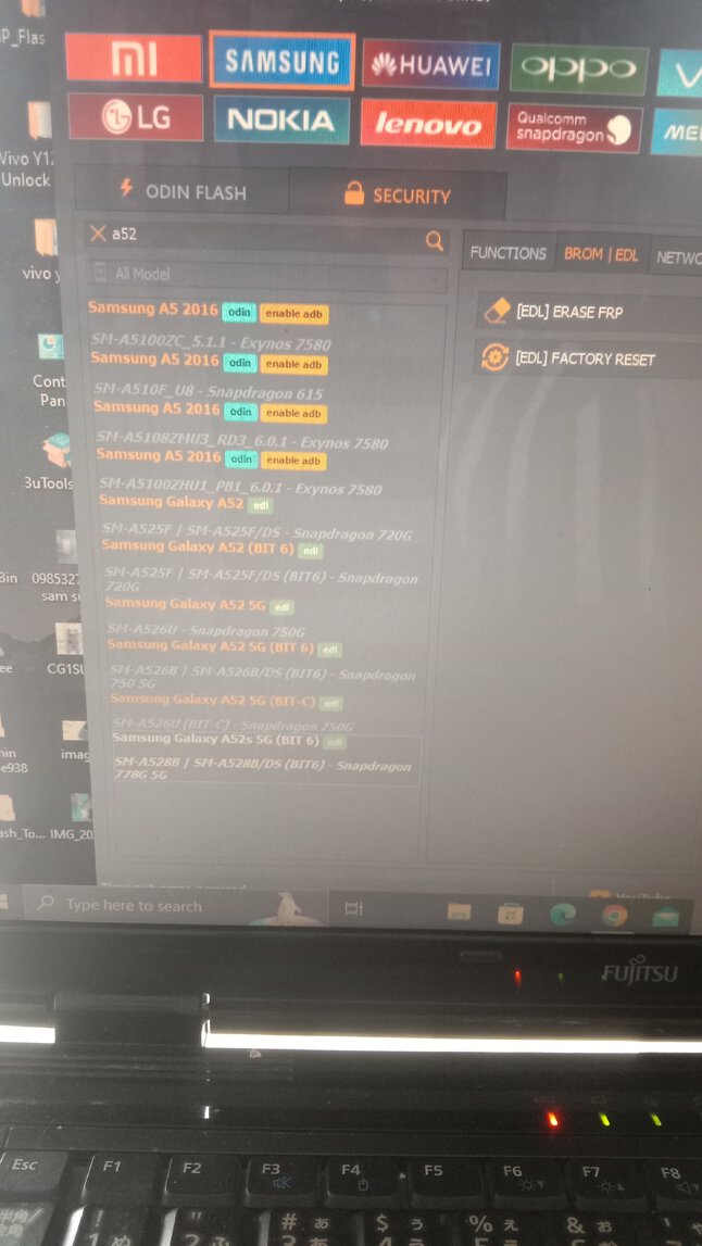

open unlocktool
Samsung tab
Samsung galaxy a52s 5g (bit 6)
EDL.mode.erase frp

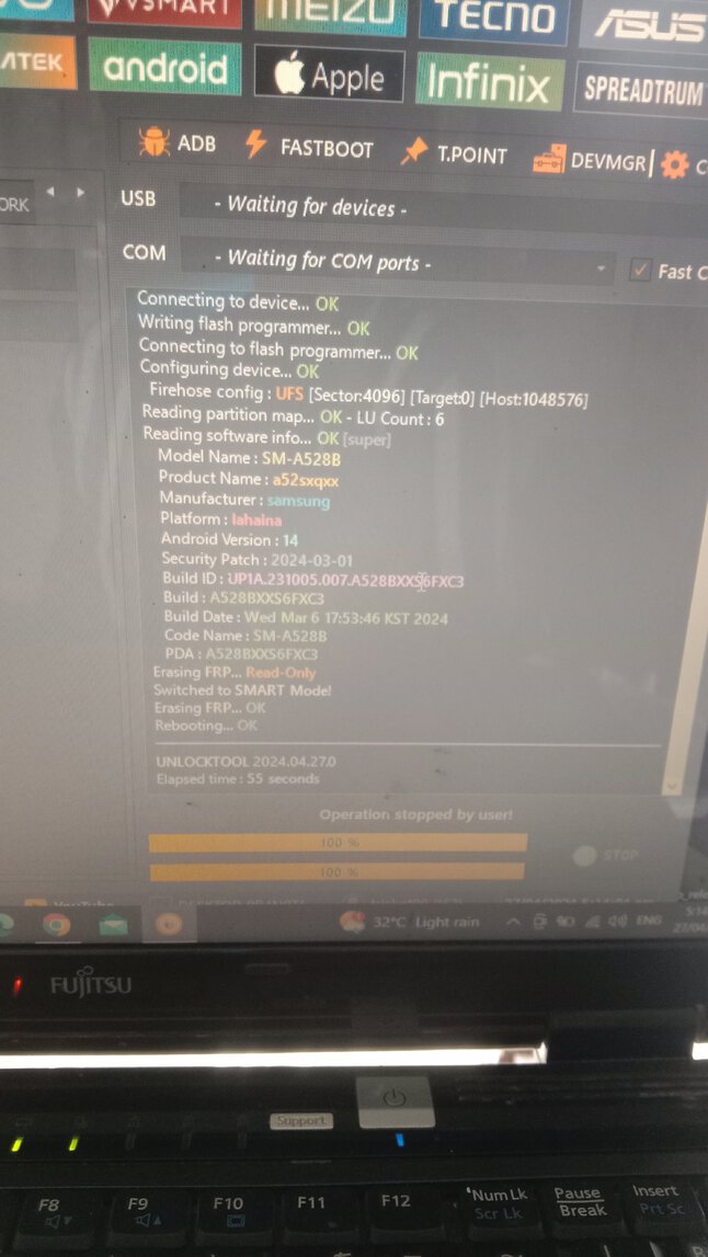

Kaylangan .ng tespoin .nasa pic na mga boss sana maka tulong
open unlocktool
Samsung tab
EDL.mode.erase frp
View attachment 34005View attachment 34006View attachment 34008
Nka connct po ba boss battery pag tp?
