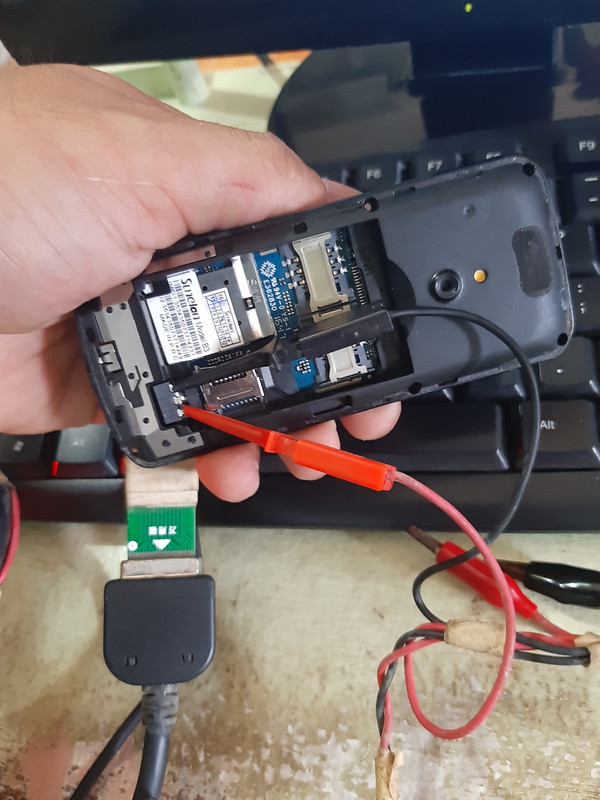

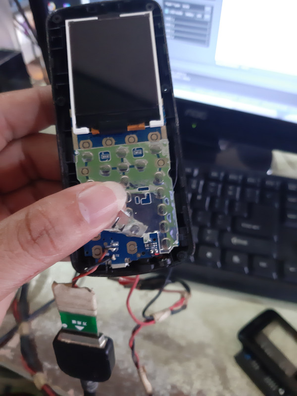

disassemble the phone first and connect the phone like this..(rx tx)

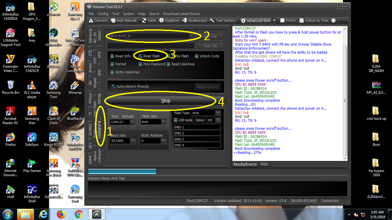

open volcano tool and make back up first..

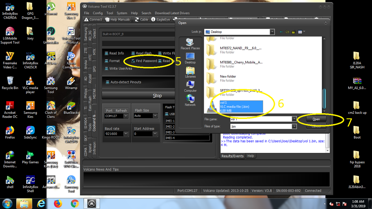

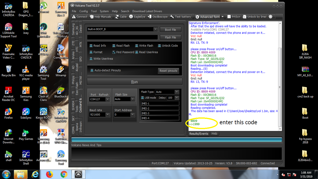

pagkatapos mag back up select find password...

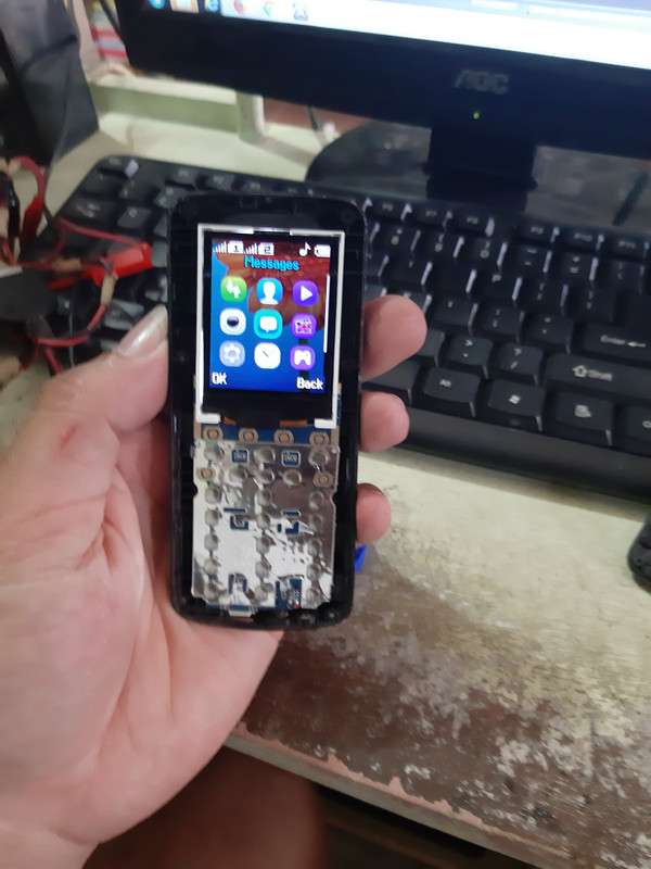

done...
