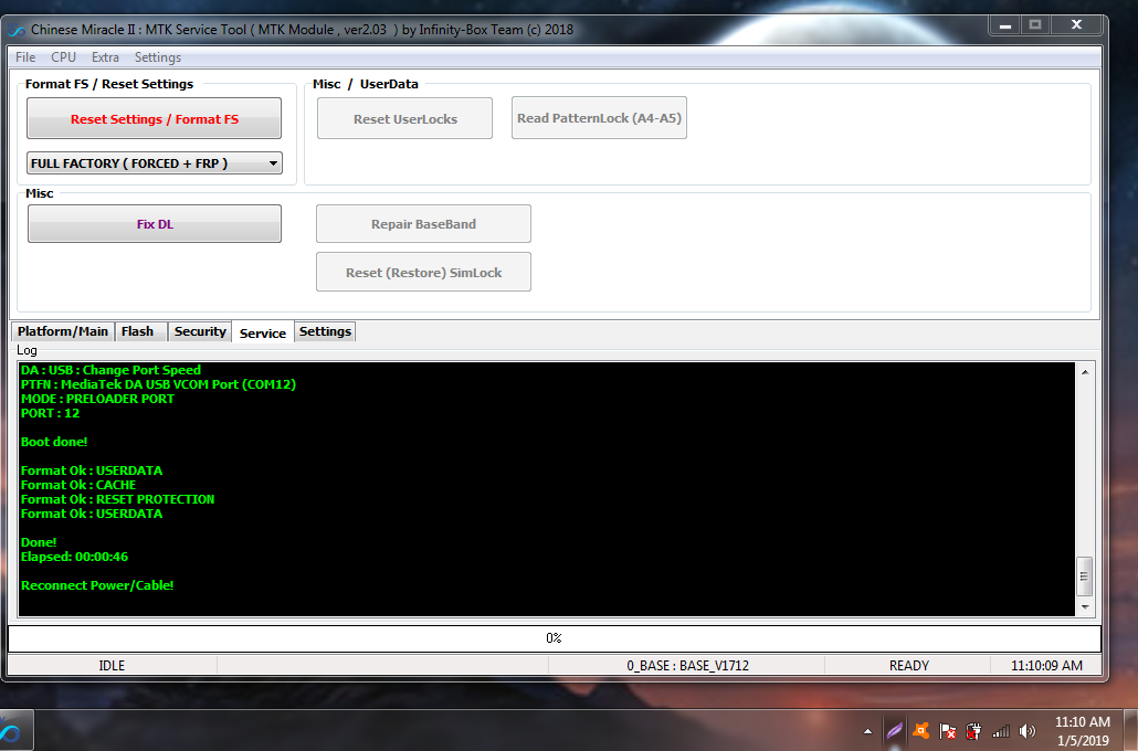

SHARE KO LANG PAGAWA SAKIN NGAYON
PASSWORD AT FRP
SUNDAN NYO NALANG MGA BOSS
Code:
Card found : 28FA2B58 , v0137
Infinity-Box Chinese Miracle MediaTek Service Module [ MTK ] v2.03
Load IDBase v123080 Ok!
Operation : Reset Settings/Format FS [ v2.03 ]
1. Make sure device is powered off. Power off, if need. Wait 20 seconds after
2. Insert USB cable in phone
Waiting for device connection ...
PTFN : MTK USB Port (COM13)
MODE : BOOTROM
PORT : 13
Waiting BOOT ack ...
BROM : Skip ACK verify
BROM : Init BROM
BROM init passed!
     CHIP : MT6580 , SBID : 0x8A00 , HWVR : 0xCA00 , SWVR : 0x0000
     TYPE : LEGACY MTK
BROM : SecLevel : 0x00000000
BROM : SecMode  : PLAIN [+PRL]
BROM : BOOTROM
MODE : 0_base : BASE_v1712 | Manual : Disabled
Fail to disable Dog!
AGENT : Look for suitable BootChain in DA ...
AGENT : MTK_AllInOne_DA.bin
AGENT : Found MT6580
AGENT : MTK_DOWNLOAD_AGENT
     BROM : Sending 1st DA ...
BROM : DA sent
BROM :Transfer control to DA ...
     DA : AGENT started!
NAND : DEVICE NOT FOUND
eMMC : OK
eMMC : 4E0001153030534A1175004D8F9F2C1D
DAInf: 4 : 2 : 156
DA : EXT_RAM NOT initialized!
eMMC : OK
eMMC : 1501004E4A5330304D0075111D2C9F8F
NAND : 000000000000000000000000
     EMI : DEV : INFINITY
     EMI : SRC : INFINITY-BOX_INTERNAL_EMIDB_v0
INIT : 0xBC : LP/DDR2 [ 0x00000000 :  [ 0 B ] ]
DRAM : DRAM: 0x20000000 [ 512.00 MB ]
     DA : DRAM ready!
DA : BOOT to 2nd DA ...
DA : Receiving HW info
        EMMC: 1501004E4A5330304D0075111D2C9F8F
        EMMC: VEN : SAMSUNG | OEM : 01 | DEV : NJS00M
        EMMC:
              BOOT1  : 0x00100000 [ 1.00 MB ]
              BOOT2  : 0x00100000 [ 1.00 MB ]
              RPMB   : 0x00020000 [ 128.00 KB ]
              USER   : 0xE9000000 [ 3.64 GB ]
        SRAM: 0x00020000 [ 128.00 KB ]
        CHIP : MT6580 , SBID : 0x8A00 , HWVR : 0xCA00 , SWVR : 0x0000 , EVOL : 0x0000
        RNID : E84AD2287B7DF3B26309306C1B96C87
 STATUS : BLANK FLASH
 BSTYLE : EMMC FLASH BOOT
DA : USB : FULL-SPEED
DA : USB : Change Port Speed
PTFN : MediaTek DA USB VCOM Port (COM12)
MODE : PRELOADER PORT
PORT : 12
Boot done!
Format Ok : USERDATA
Format Ok : CACHE
Format Ok : RESET PROTECTION
Done!
Elapsed: 00:00:46
Reconnect Power/Cable!
