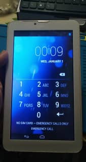

share ko lang mga lodi samsung clone M706-4 passwrd

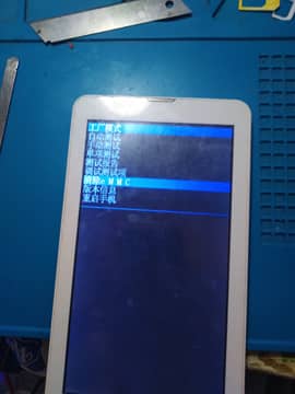

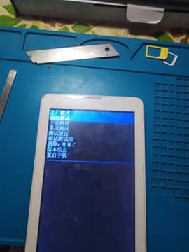

HARD RESET na chenese program clear eMMc
hold power swicth
hold volume down
hintayin lumabas ung chinese
then select mo ung
eMMc hintayin mo matapos at tangal
na ung passwrd nya
