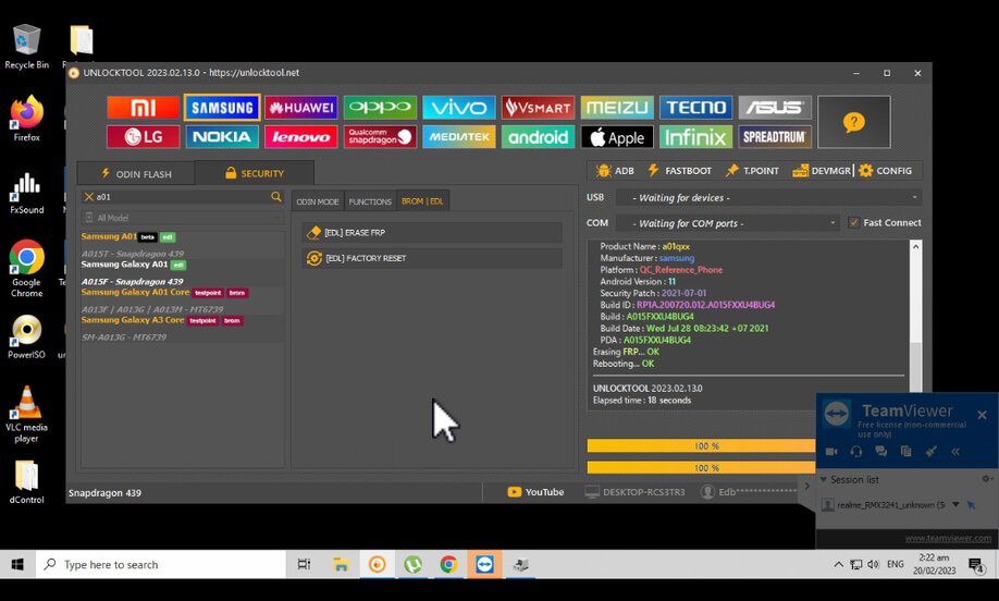

OPEN UT
SAMSUNG TAB
SEARCH SAMSUNG GALAXY A015F (DALAWA SILA YUNG ISA NAKA BETA PA ANG ICCLICK NIYO KUNG ANO MODEL NG UNIT NA HAWAK NYO)
AFTER THAT

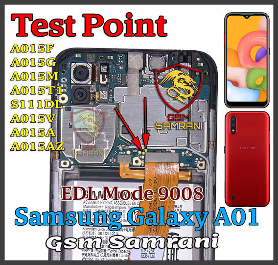

CLICK : [EDL] ERASE FRP
Baklas Unit para matestpoint (SEE THE PICTURE BELOW)
⚠️ (DISCONNECT BATTERY BEFORE TEST POINT)
TESTPOINT THEN SALPAK CABLE
WAIT UNTIL DONE ✅

DONE THIS VIA REMOTE SERVICE
PROCESS :
OPEN UT
SAMSUNG TAB
AFTER THAT
WAIT UNTIL DONE ✅

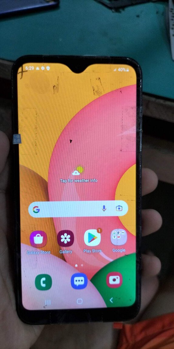

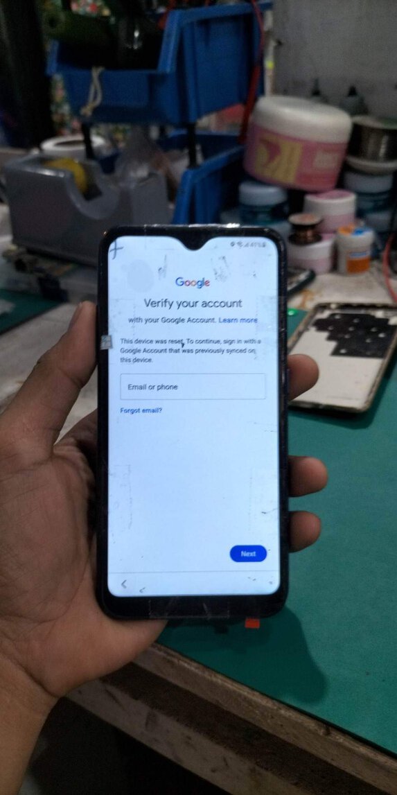

View attachment 19346View attachment 19347View attachment 19348
nice boss tested
