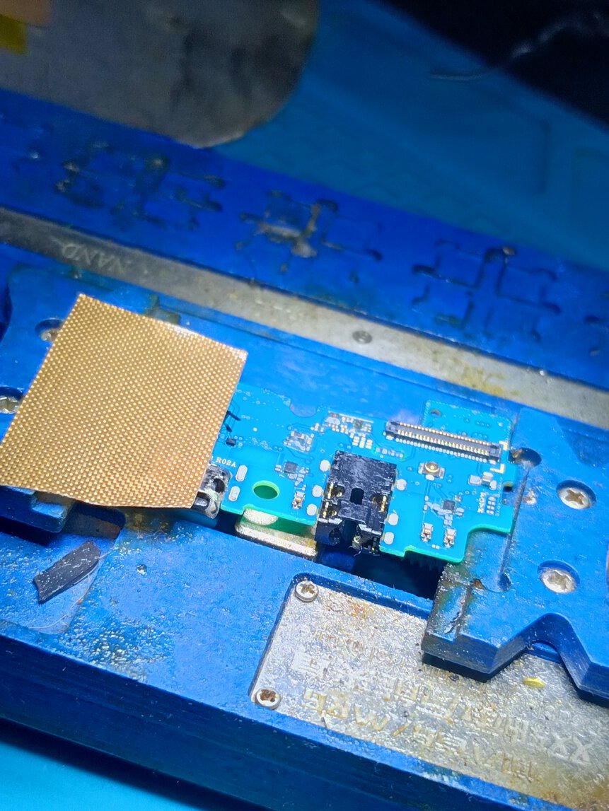

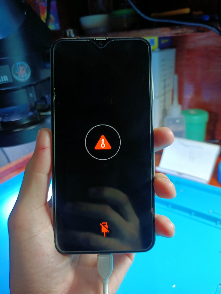

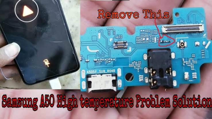

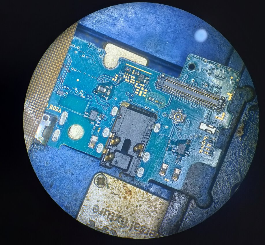

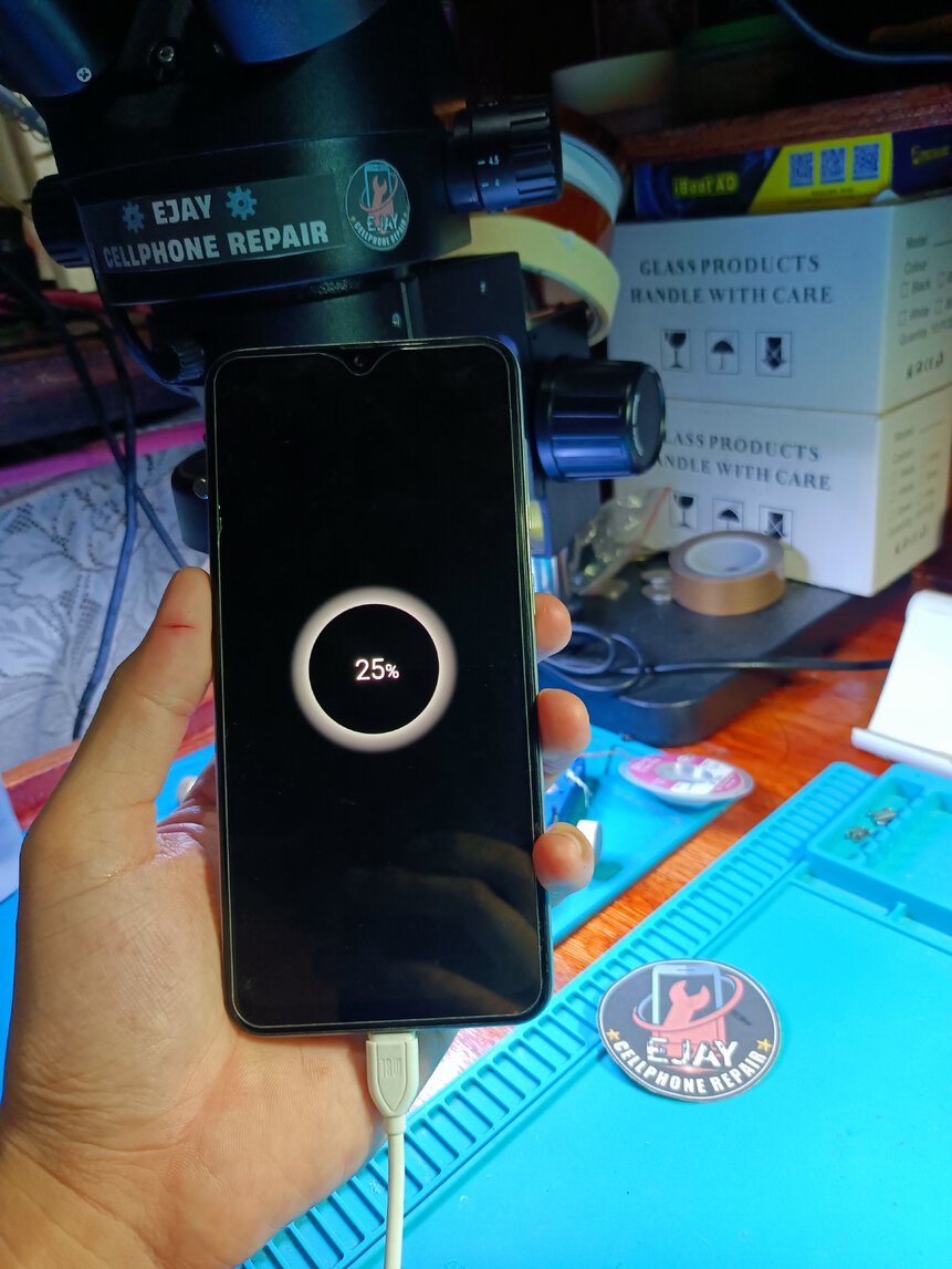

nice2x tnxCOMMON ISSUE NA TO NI A20/A30/A50/A70 at iba pa 3 KUTO REMOVE NASA PICTURE TIGNAN NALANG
WALA NA STEP BY STEP HAHA BAKLAS CP LOOK AT THE CHARGING BOARD ONLY REMOVE THE 3CAPS (SEE THE PIC)
thanks master.. big help.. legitCOMMON ISSUE NA TO NI A20/A30/A50/A70 at iba pa 3 KUTO REMOVE NASA PICTURE TIGNAN NALANG
samsung a50.. same issue.. thanks master.. legit talaga... big helpCOMMON ISSUE NA TO NI A20/A30/A50/A70 at iba pa 3 KUTO REMOVE NASA PICTURE TIGNAN NALANG
