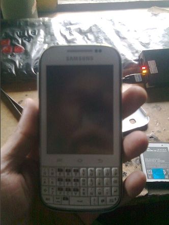

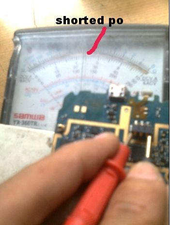

Problem: Shorted And No Power
History: Pagkaka Kwento Ni Tomer Naligo Daw Sa Swimming Pool (aba Sosyal)

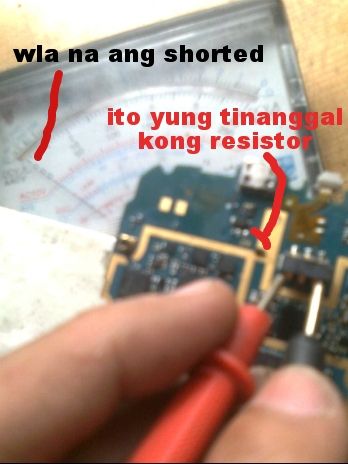

Disassembly Ang Unit,Sempre Lines Mo Na Ang Unit
Pero Ganun Parin,shorted Parin
Dahil Hindi Umiinit Kaya Mahirap Mahanap Ang Salarin

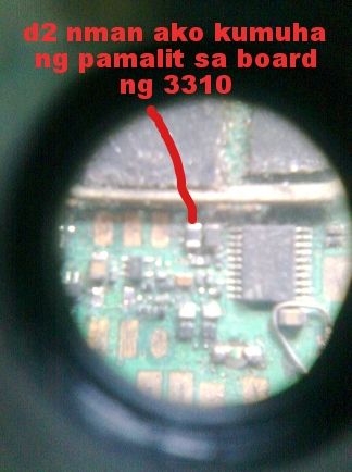

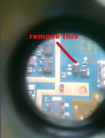

So Dahil Malines Na Ang Unit May Nakita Akong Resistor Na Sunog

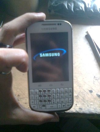

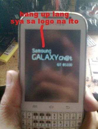

kala ko ok na kc nag power na sya
kaso hang pa sa logo
Sinubukan Kong e-Flash Kaso Di ma-Tect Ng pc
Baklas Ulit Ang Unit,Cleaning Ko Yung Usb Charger
Salpak Ulit Sa pc Wala Parin Nangyari

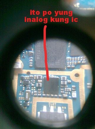

Baklas Na Naman Ang Unit,Isip isip Kung Anu Gagawin

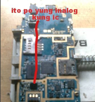

Sinubukan Kung alogin Yung ic Hindi Ko Alam
Kung Anung Pangalan Ng ic Na Ito

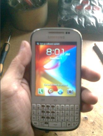

Palamig Ko Muna Yung Unit,Usi Usi Mo Na

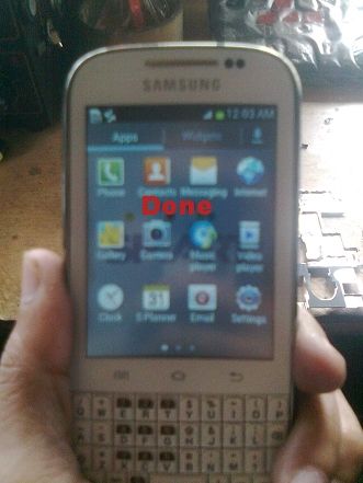

At Ng Lumamig Na Power On Ko Na Ang Unit Boooommm
