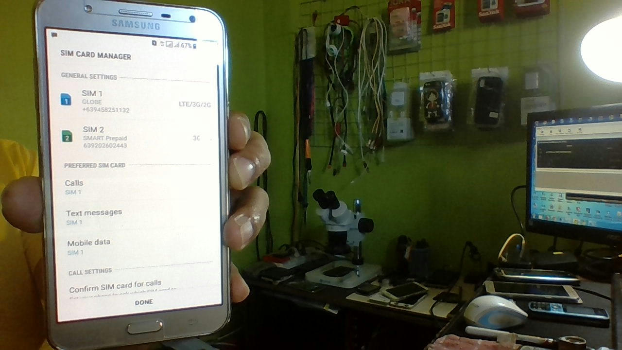

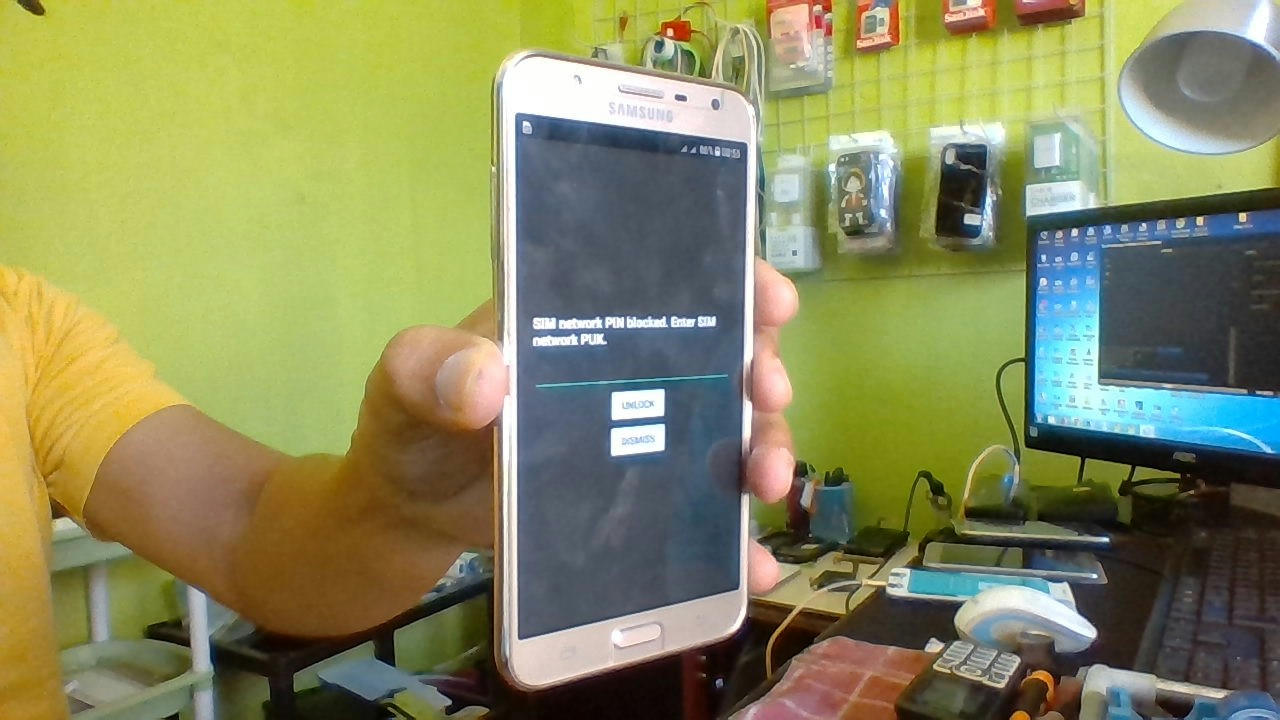

Samsung Galaxy Core J7(SM-J701f) Unlocked Done by Z3x No need Credit

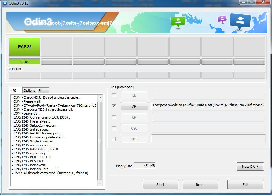

Root File:http://www.mediafire.com/file/h5mcb9afg3r5gy2/CF-Auto-Root-j7xelte-j7xeltexx-smj701f+need+reset+verification+failed..+pang+j710f+tong+root+pero+pwede+sa+j701f..zip
ScreenShots;
Open Odin then Click PDA Tab then load root file after rooting need to reset phone and roo it again..

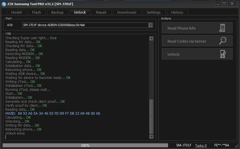

Proceed to Unlock now, Open Z3x tool, select exact model, then click unlock tab and wait until finish process

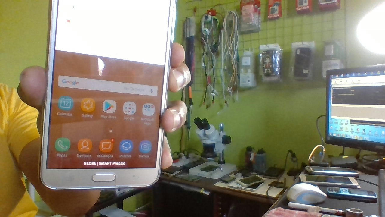

Done:):):)
