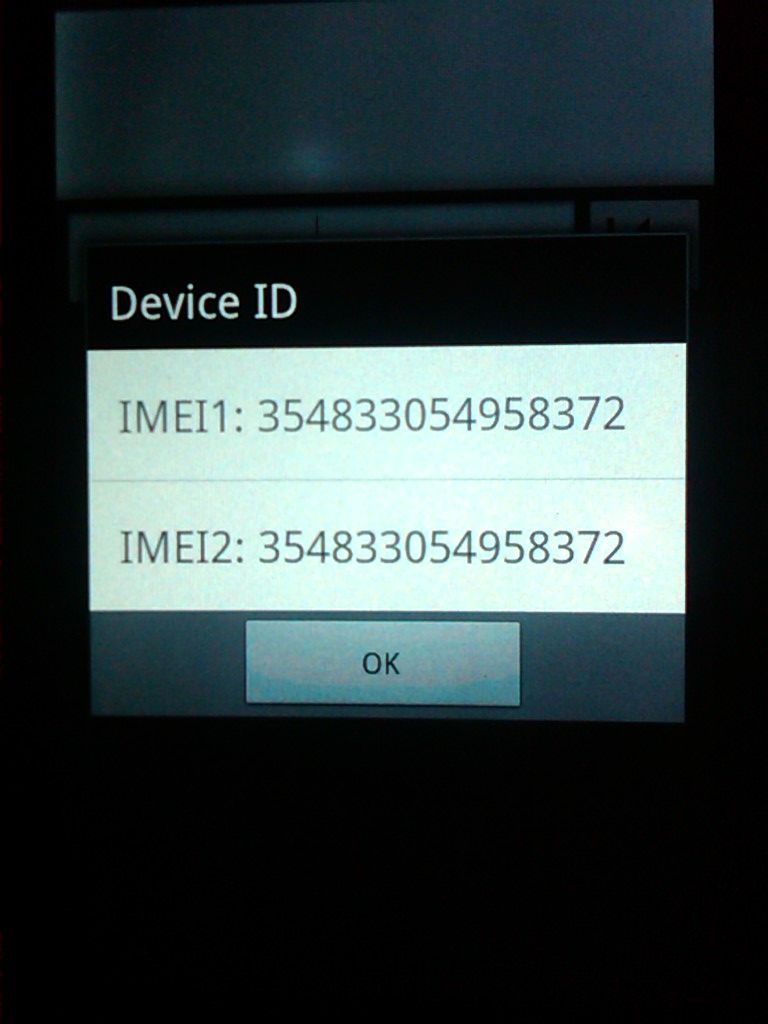

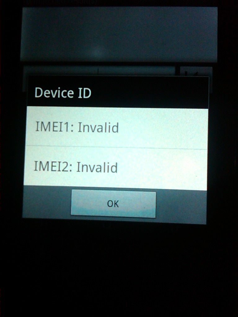

share ko lang po itong Samsung Galaxy S Note I9220, History ng unit format ng owner kasi internal memory full na daw nabigla sya pagopen nya Ivalid IMEI na unit, ito po ginawa ko
*OPEN MTKDROID TOOLS
*CONNECT CABLE TO DEVICE
- wait lang na madetect unit
* Then Thick IMEI/NVram
- then Rebuild IMEI no need to root
* After na marebuild imei Reboot Device
Congratz Imei completely rebuild.
Finish Product
For Reference only
