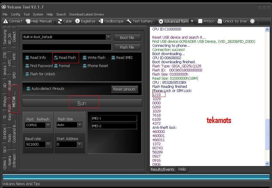

Samsung galaxy s III clone phone code! DONE
unit : samsung galaxy s III clone model 9300
status : phone code
chips : mstar
tools
volcano box
jig P-07A
procedure
1. connect box, open volcano GUI
2. connect unit to volcano with jig P-07A
3. manual detect..choose mstar then click detect
4. set pinout, go to mstar tab
5. read flash, click run and wait to finish
6. after read flash many code shows on logs
7 try to input one by one until you get the right code then disable on settings
DONE!
