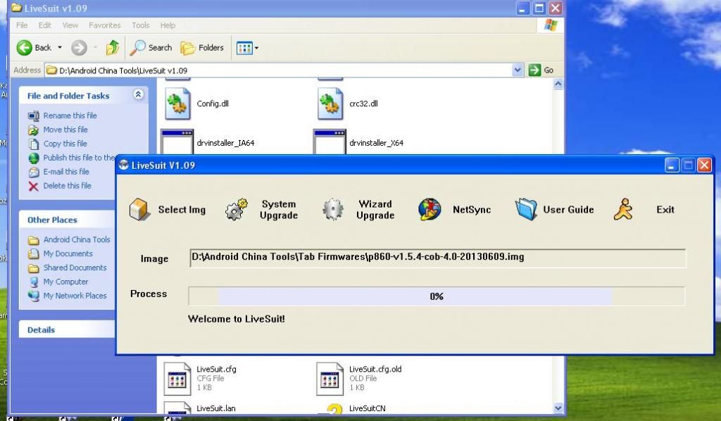

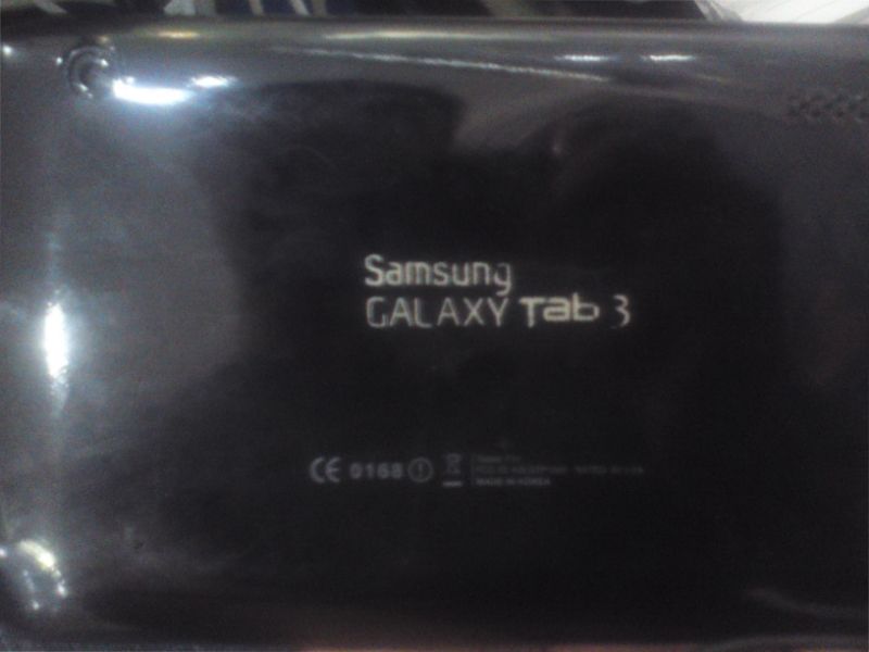

Samsung galaxy tab 3 korea, Board id: tanju a13-p860-v8.1 2013-08-22

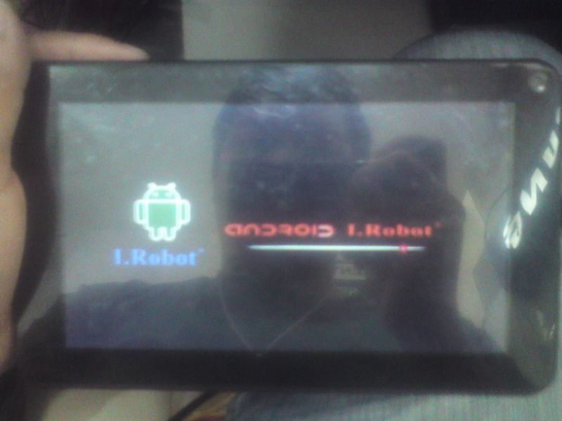

problem hang lang sa logo, first try ko sa wipe rom easy a10-a13 pero ganun pa rin..
kaya proceed sa next step hanap ng firmware at may nakita naman tested for me
ito po ang link ng firmware - http://www.4shared.com/rar/9xseaSB1ba/JHAYSON-13_p860-v154-cob-40-20.htm
flash ko using livesuit v1.09

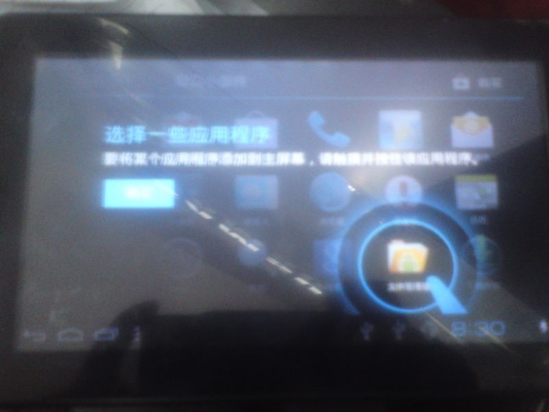

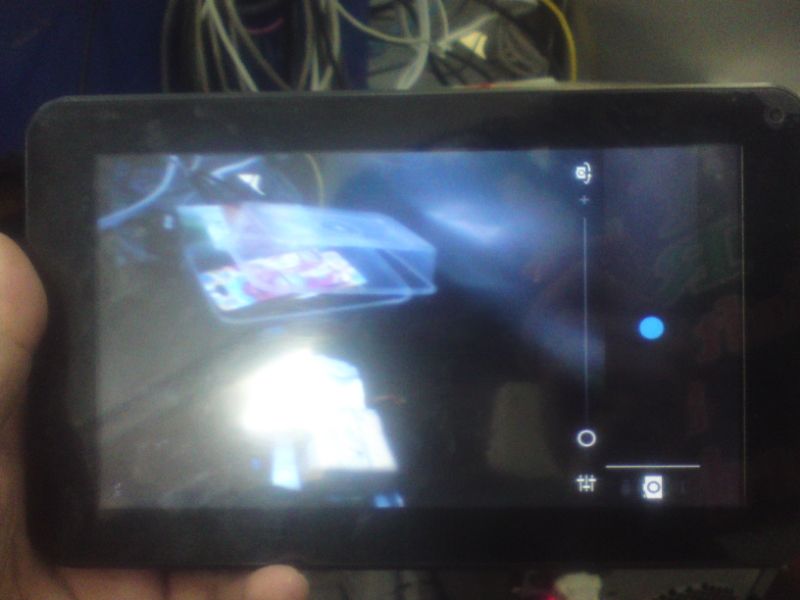

done...

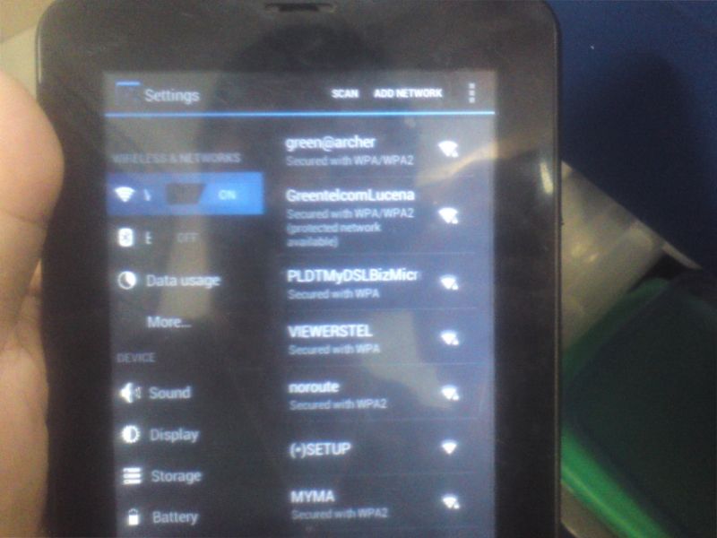

testing, wifi is working

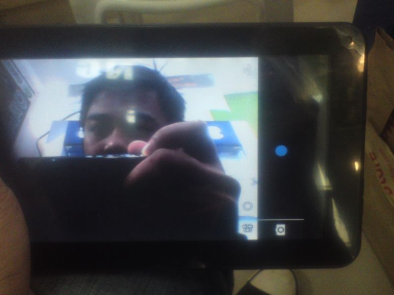

front camera
back camera
