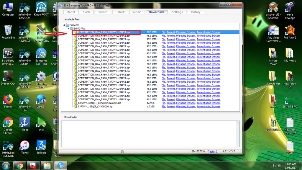

TOOLS: DOWNLOAD NYO LANG PO SA SUPPORT NG Z3X MEDYO MALAKI KASI YUNG FILE DI KO MA UPLOAD

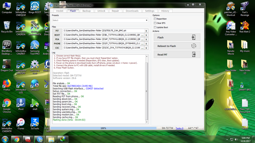

ito po yung combination na ginamit ko

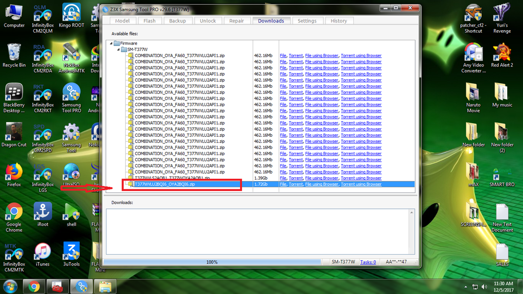

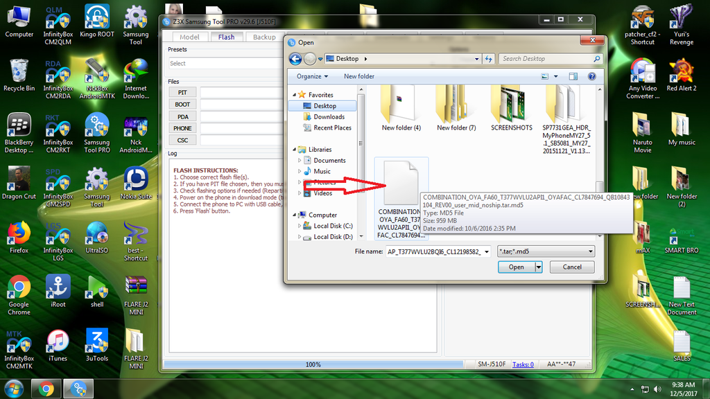

ito naman po yung firmware na ginamit ko
1st move need natin flash gamit yung full firmware para bumalik sa normal function ng unit naka stock na kasi sa odin mode
after flash ok na po unit pero naka FRP LOCK parin

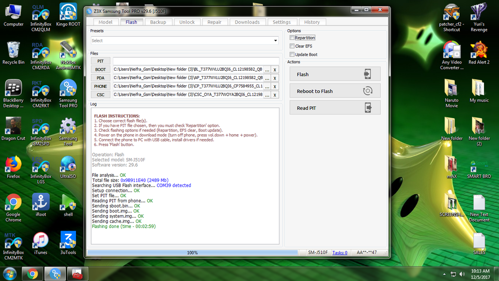

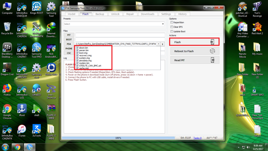

2nd move flash with COMBINATION FILE
after flash via combination file ito na resulta
3rd moves flash ulit sa 4 files pero ito lang po check nyo sa tab nga firmware
system , sboot , boot , recovery , cache
note: dapat ang limang yan lang ang flash natin

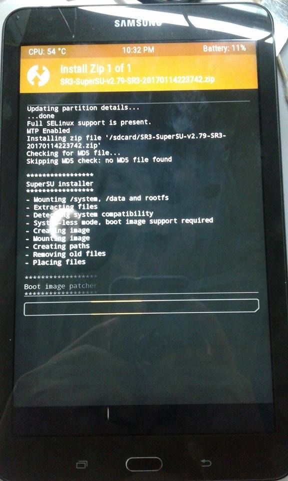

COPY SR3-SuperSU-v2.79-SR3-20170114223742 to your SD CARD pwede rin sa mismong tab nyo lagay

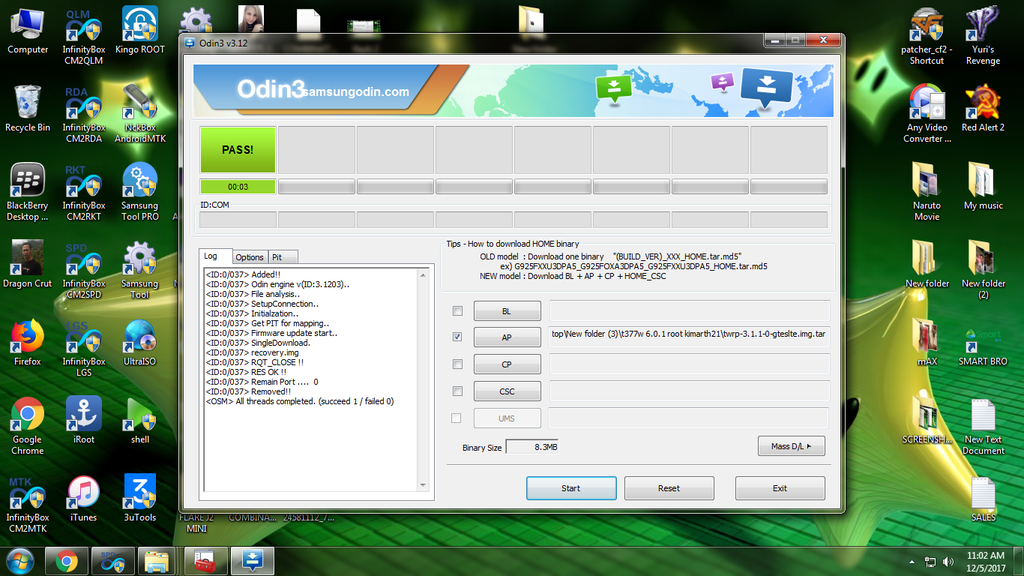

FLASH twrp-3.1.1-0-gteslte.img SA ODIN
AFTER FLASH REBOOT YOUR DEVICE TO RECOVERY MANUAL INSTALL SR3-SuperSU-v2.79-SR3-20170114223742

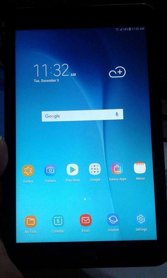

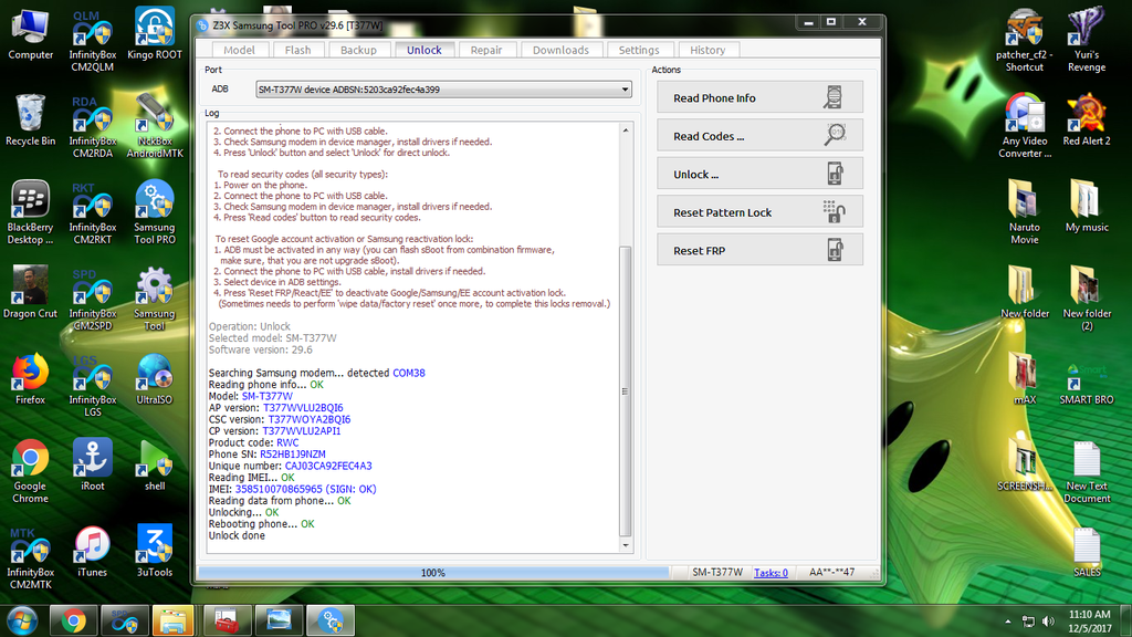

PROCEED NA PO TAYO SA UNLOCKING
CLICK DIRECT UNLOCK

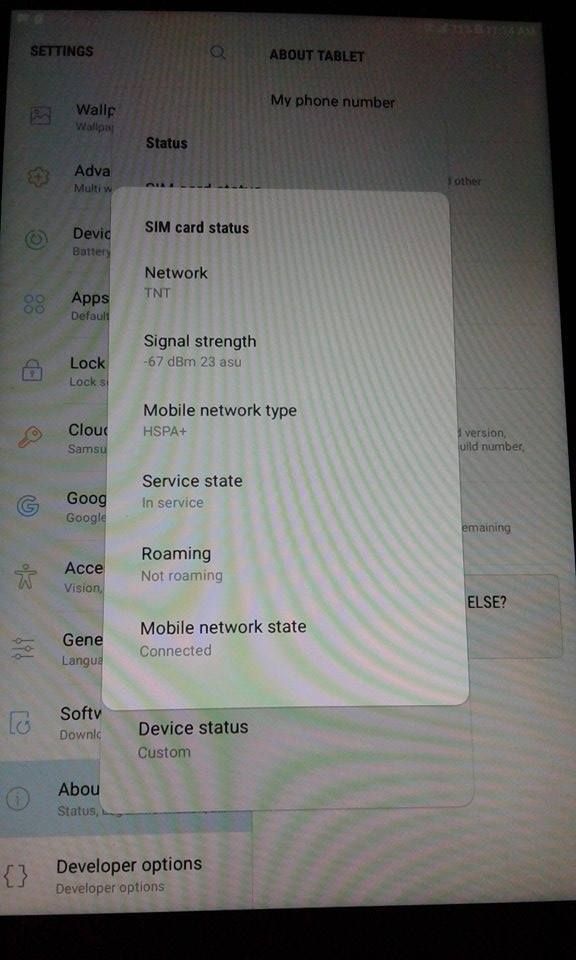

ITO NA PINIS PRODUCT NATIN
YAN DONE NA PO MGA MASTER NAKAPAG POST DIN ULIT
