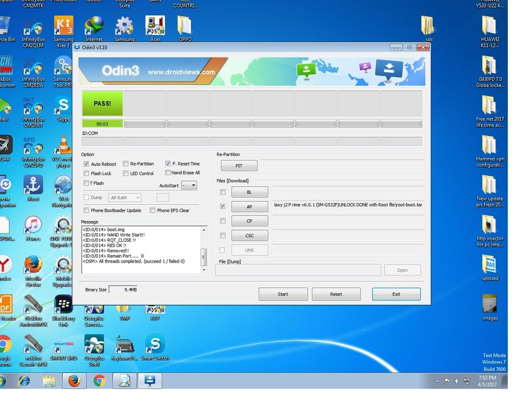

gud day mga sir. malapit na holy week. but before that. share ko lang itong gawa ko this time. model: G532g. locked sa globe. need to unlock. first need to root muna. ang pag root na ginawa ko. manual lang. ok let's start.
PROCEDURE:
-enable first the USB DEBUG. and OEM option. in developer.
-down this root filehttp://www.mediafire.com/file/fxnjcfxce7prbqh/ROOT-G532F.zip g532g, g532f, at g532m. ay supported nyan.
-then after ma-download. extract na. open odin. then load the root file manually. pero after ng root. may password yan. wag nyong hard reset. or else mag bootlop yang unit nyo. basta after ng root. at may pattern. hayaan nyo lang. babasahin parin ng box nyo yn.

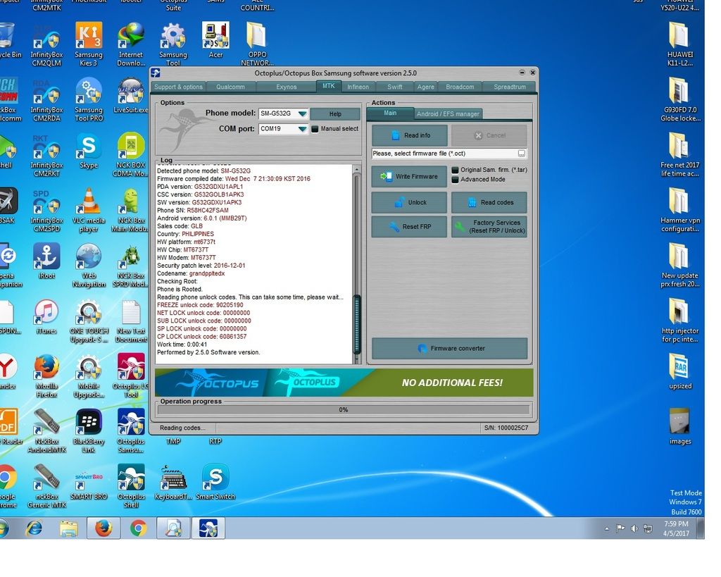

open si pusit. choose the right model.. hit read info. then hit read code. sakin kasi read code lang. at lalabas na yung unlocking code. pati na yung pattern code ng phone nyo. apply nyo na lang manually. then boom. pera na ulit yan. here my screen shot.
screen shot ng root file.
then screen shot ng unlocking process. makikita nyo lahat ng code dyan. na need nyong i-apply sa phone nyo. including the paterrn lock code.
ayun ang pattern code. CP LOCK CODE. alam nyo na ang susunod dyan. walang photo yung finish product. medyo nagmamadali si tomer eh. for reference lang mga idol. tnx for viewing.

up ko lang po ito bakit sakin incorrect password entered lagi... na read naman ng pusit boss yun codes
boss tested bayan sa G532G

dto ako natagalan may code pa kasi
piro sulit naman na unlock ko parin
