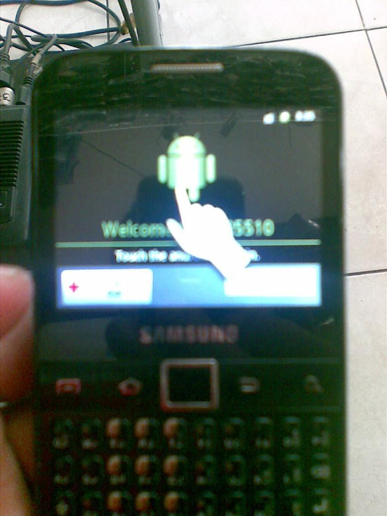

SAMSUNG gt-b5510 HANG & LOGO ONLY
DONE BY ODIN v1.85
SHARE KO LANG PO MGA BOSS BAKA MAKATULONG DIN.
Problem: Hang and logo only
Hard reset by pressing or holding volume up + home and power on.
no luck......=((
Ito po ang ginawa ko
Download odin v1.85
http://www.4shared.com/file/RYxLQjAo...ownloader.html
Download firmware S5360 pwede.
http://www.4shared.com/zip/WKBL3GY7/...KK1_OLBKK1.htm
Press and hold volume down + home and power on
Run the ODIN v1.87 and load the firmware.
Insert the USB chord and click start.
ito po tapos na
